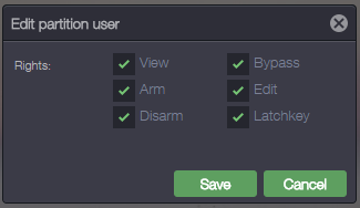

Can you check which options are enabled when you open Security partition settings - USERS tab - click on the name of the additional user.
