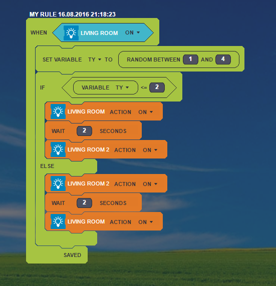

try this, let me know if it works
Hi Adrian,
I have tested the rule witch i created (as show below in this topic) and it works flawless, so thanks for that.

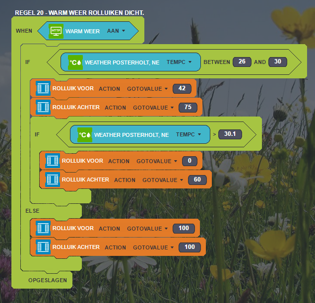

I hope you can help me with an other rule to understand why it doesn't work like i expected.
The meaning of this rule is when i turn on the virtual switch and the temp. is between 26 and 30 C
the schutters are closing to the given point. When the temp. is above 30.1 C the shutters had to close a little bit more. So far so good. Now comes the part witch i don't understand. When the temp. drops under 25 C the shutters don't go open. I hope you can tell me what i did wrong.
Thanks in advance
Schedule every day at time you like
put a random number between 1 and 10 into a variable
if variable is <= 5 then first A on and then B on
else first B on and than A on
ready

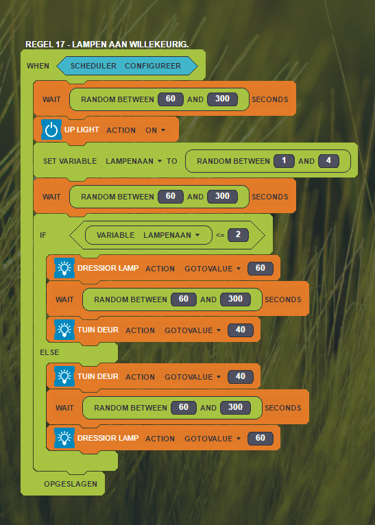

Both thanks for your quick response.
I create a rule so i can try this.
Other suggestions or ideas are always welkom.
