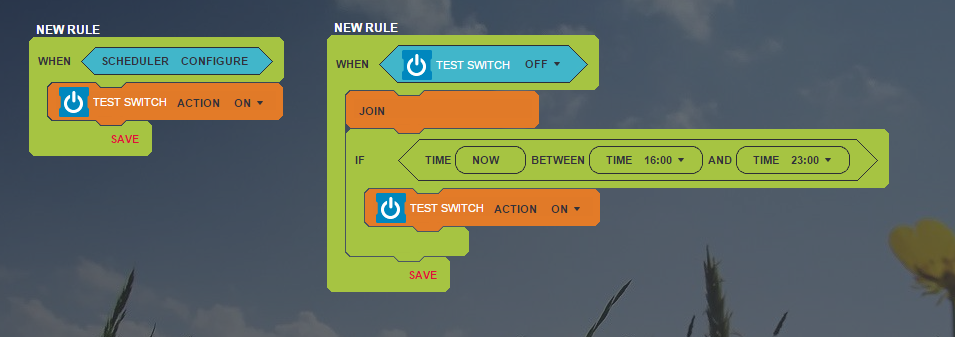

I think you are after something like this. One rule will turn the light on every day at whatever time you put into the scheduler. The second will turn the light back on if it is turned off during your specified timeframe.
If this is not correct, please explain you intentions again. Hope this helps
Thank you for the suggestion, but your first rule that uses the scheduler turns on the light and it stays on, even without the 2nd rule, turning it off from the control center/mobile app - once the interval lapses, the light turns back on.
The 2nd rule with the JOIN does not appear to have any effect. If I disable that rule, the results are the same and even if combined with my original rule, the light remains ON/turns back on - indefinitely.

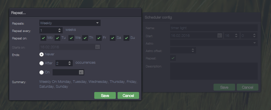

Remove, not disable, any other rules you have established with this switch. Just have the rules I posted. If you want to turn the light off at 23:01 you can make another rule like the first with the scheduler. Attached is a pic of how the "on" scheduler should look

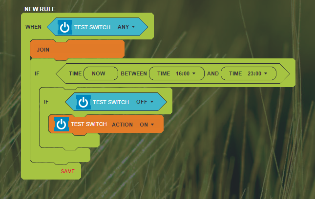

I have found, with some Zipaboxes, that disabling a rule did not always stop it from working or conflicting with other rules. Not sure why this happens, so to be sure I just remove them. Alternatively you could try the second rule like this.
Thanks for the info about disabled rules not being...disabled. I will experiment more once I verify the suggestion by Olivier Legros below.

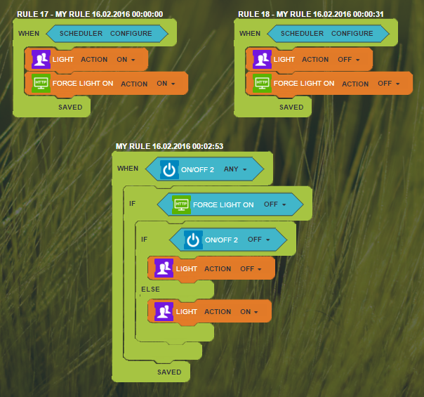

I would create a virtual switch 'Force Light On' that will be triggered by 2 schedulers: a daily one that 4pm that will turn the light on and set the virtual switch to 'on', and a second one at 11pm that will turn the light off and set the virtual switch to off.
Then a third rule will be triggered when your actual switch is pressed and verify the virtual switch 'Force Light On' is not on.
Basically the virtual switch acts as a 'global variable'
Edit: just tried, works well :)
