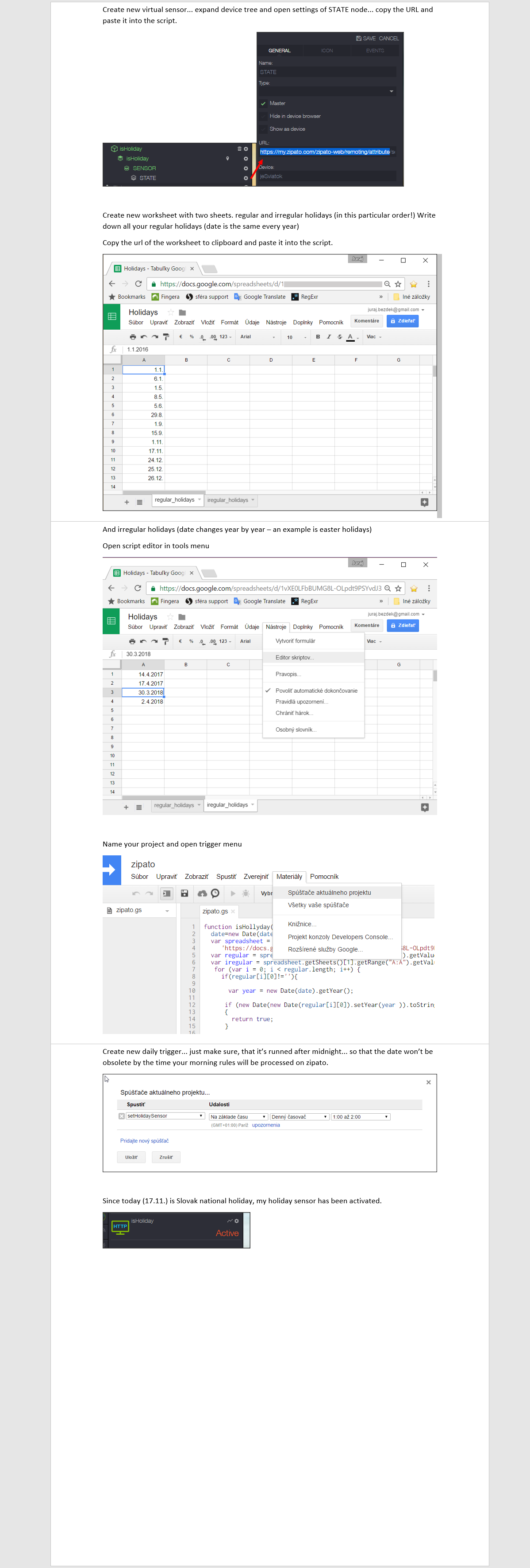

1. create virtual sensor on zipato named "isHoliday" (and control it's state from some external app)
2. create google workbook with two sheets.
First will have only regular holidays, such as christmas, which is always on the 24.12. every year.
Second will have irregular holidays, such as easter.
These holidays differs every year so you can't create simple rule, like
"if (month ==3 and day == 24 ) then". But you can write them down for
many years in front.
3. create google app script, that will be triggered
every night and call zipato isHoliday virtual sensor, with state calculated by
simple logic:
- IF ( currentDate is in regular holidays.setYear(currentDate.getYear)) then
>>return TRUE;
- ELSE IF (currentDate is in Irregular holidays) then
>>return true;
- ELSE
>>return false;
4. Use state of isHoliday virtual sensor to check whether I am going to work this morning :)
I am attaching simple tutorial with pictures and also the script it's self. Enjoy:)

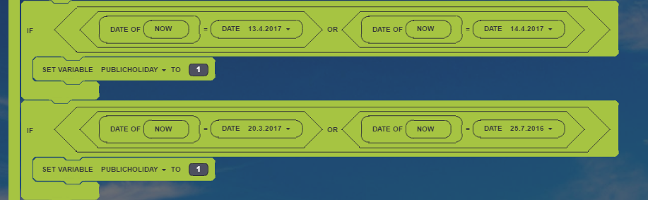

That's an interesting approach. I actually do this with rules in Zipabox itself. I put in the standard ones and the variable ones, and just make a note to update the variable ones every year.
Thas was my first attempt. It was painful to create such long rule... since we have much more holidays than it's common, it was lot's of clicks :)
But I didn't wanted to remember to change the rule every year... this is much more conveniant and also testable, since I could easily debug it in google IDE. Now I can be almost sure that it will work... working with dateTime in zipato more like trial&fail process
Yeah and long rules are a problem. Initially I tried to make one large rule for public holidays and holidays (vacations), but the Zipabox is unable to store rules that are more than a couple of screens long.
You may also notice that the more nested conditions you have, the more quickly you hit this invisible limit.
When a rule gets large or complex, you have to be really careful. Refresh the page often to check that your changes have actually been saved!
