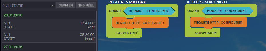

I created a virtual sensor, that I update with two rules, one that is triggered at sunset and another one at sunrise.
Each rule is calling the HTTP request to change state to 1 and 0 respectively.

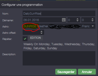

In order to be able to trigger the rule at sunset/sunrise, you need to
- add a virtual weather station.
- once this is done, the when trigger can be based on astro schedule that are the sunset/sunrise time respectively.

I use for this a simple virtual switch. It is called "daylight". At sunrise it is set to on and at sunset to off. Ready.

I haven't played with switches yet. Thanks for comment. I see it's easier to program the rule with a switch. Its a matter of taste, but I like the idea of a sensor (a non-virtual device would be a sensor). Though maybe associations can benefit of a switch.

A switch is allways also a sensor.....
you can use it in rules as sensors
