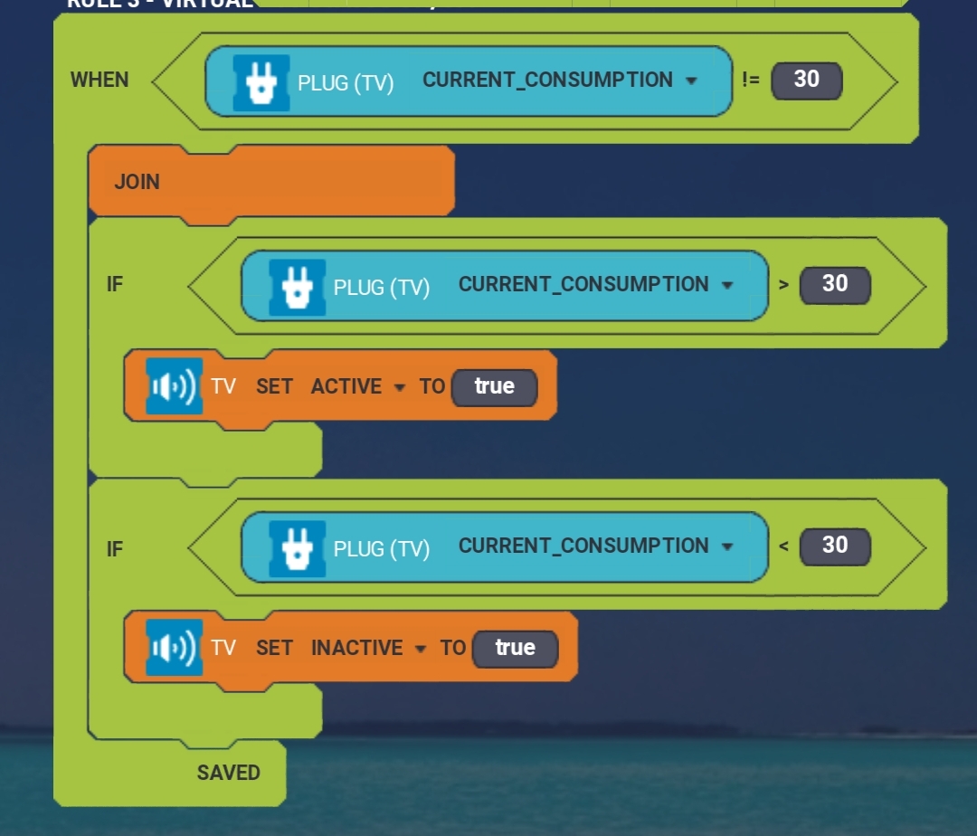

Hello. I would like to make a virtual sensor that will show status if my TV is on (active) or off (inactive) based on the power consumption. I made a rule (attached) but it does not work - any help. Thx.

error in the rule is in the 2nd IF statement
Dont overwrite the text the system adds. When you set the INACTIVE, the system adds text FALSE
Leave it FALSE, dont change to TRUE
A little contrapredictive, but the way it works.
