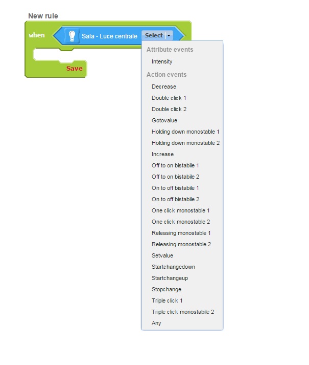

Small update, I've tried with old rule editor and adding a dimmer form "control" menu show all the option (screenshot "old-editor.jpg").

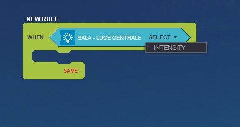

Doing the same thing in the new editor shows only "intensity" as available option (screenshot "new-editor.jpg")

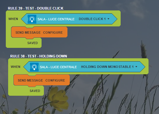

Yesterday I created two very simple rules to test "double click monostable 1" and "holding down monostable 1" (see attachments).
Sadly none of them works.
I'd like to remark the fact that this sort of rules were working flawlessly until three weeks ago when, without any action on my side, they stopped to work.
At first the option to use "double click", "holding down", etc. was disappeared in rule creator.
After that support (wrongly) closed the ticket these options came back but they don't work at all!
