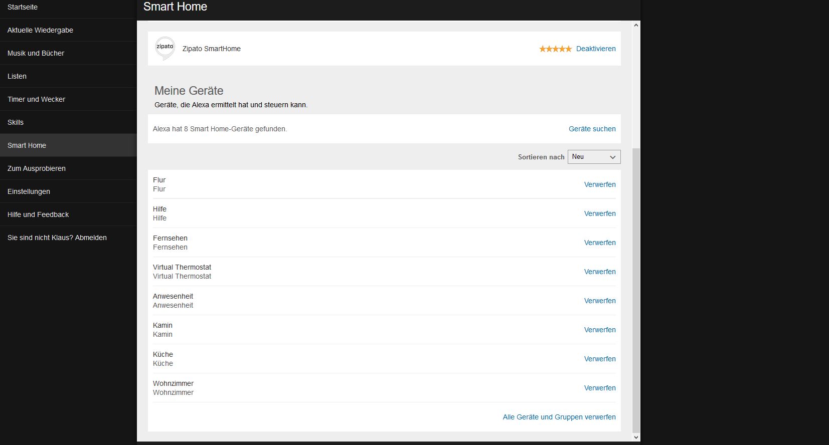

I also have a zipabox and just got amazon echo dot. I only enabled the skill on Alexa side but haven't had the time to set it up and test. I also use IFTTT for some stuff, exactly what are you trying to achieve?
I think if you want to trigger actions via IFTTT you should just use IFTTT. If you want to use actions within the zipato system I would use the native alexa support, it´s faster than IFTTT and you can use single devices, virtual switches and scenes.
Perhaps you could explain more detailed what you want to archive, than it would be easier for us to give an advice.
