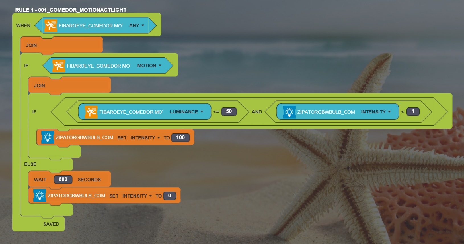

Why wait for 600 secs the first time?
Sensor: Fibaro Motion Sensor
Actuator: Zipato RGBW Bulb
Purpose of the rule: Set RGBW bulb luminosity to 100% if the motion sensor has detected motion and the luminosity in the room is less than 50 lux, also this rule will only turn on the light if the bulb is completely off. This is so if you entered the room and then you activated an scene, lets say, you dim the light to 50% this rule wont override the luminosity set by the scene.

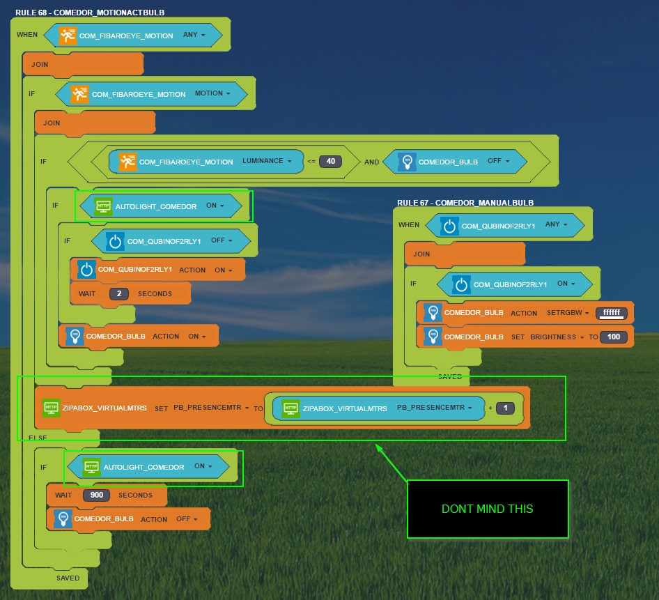

Hi ive tryed this rule, iexperience that if the lights are on i does not turn on the lights, (ive checked this since it turns on 2 lights) but the rule starts and it turns off the lights after the given seconds,
So if you turn on the lights manualy its on until there movement, Then it wil turn off after the time given in the rule.
have a smart solution for that.?
Hello Stian,
Sorry for the delayed response. If you have two bulbs that you want to operate I would recommend you to evaluate both devices' intensity on the rule (IF luminosity<50 AND ZipatoBulb1Intensity<1 OR ZipatoBulb2Intensity<1 THEN turn ON the lights)
I wouldn't recommend you to mix manual and automatic switch in the same rule, I use separate rules for that and it works good. Regarding the auto OFF function I also tried to do something that if you manually switch ON the light it will stay ON regardless of motion, the problem I had is that I use Qubino Flush Relays and the INPUT of the switch can be out of sync from the OUTPUT i. e. If the light turns on automatically (OUTPUT ON) and then I press the switch, the OUTPUT will be off but the input will be ON so after several tries I gave up with that and I created a virtual switch called Autolight, that way if i want the light to me manually controlled then I turn this switch OFF and it works as expected. See below.

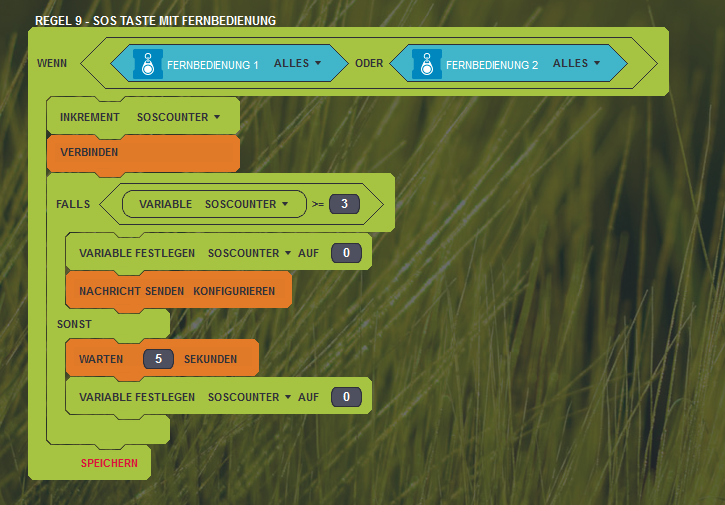

Hi Guys. Found this veeeery usefull. I am a newbie to the zipato rules, and I am trying to establish a rule with is set off by double(or triple)pressing on, with a Nexa LWST-605. Any pointers to get me going in the right direction?
I´m not sure if this is what you are looking for: I use it as an SOS Counter to send an emergency mail if my mother presses one button of the remote three times. Perhaps useful as a first approach (I´m not quite sure if Increment is part of standard package. If not, you need Pro-Features or you have to rewrite it with a decrement. Increment or decrement is part of pro-features)
Files: sos.PNG
Hi Klaus. It did not really do the trick. Are you able to explain your rule, for me to completely understand? How does the rule understand that it is triggered by a push on the button, for example. Appreciate it.
Thats easy: Everytime, one of the remotes (which I use to switch on and off some lights) is pressed, the variable "SOSCounter" is increased by one. So it starts with a zero and after the first push it becomes one. Verbinden (join) makes sure that the rule startes again, if it is "retriggered" during the run. So after the first press of a button "SOS Counter" becomes 1 and if the button is pressed again before the time of the "Falls" loop is over (it waits five seconds after the when) this loop starts again. So the next time the variable becomes 2. If I press again during the next run (again five seconds) the variable becomes 3 and the message is being send. If I don´t push a button within those five seconds, the rule comes to an end and resets the variable to zero again. So the message only comes when the button is pressed three times in fast (within five seconds) succesion.
Perhaps you don´t have the pro feature? I thought one of both funcitions (decrement or increment) of a variable is included in the basic package but I might have been wrong. I just looked it up and now I think you need the pro feature for increment / decrement. ;-((
https://www.zipato.com/how-it-works/features
Thank you for a thorough explenation, got it to work now. I have pro-feature. Got it working now. Thank you very much for pointing the direction.
Hi Klaus. Thanks for responding. I will give it a go and get back to you.

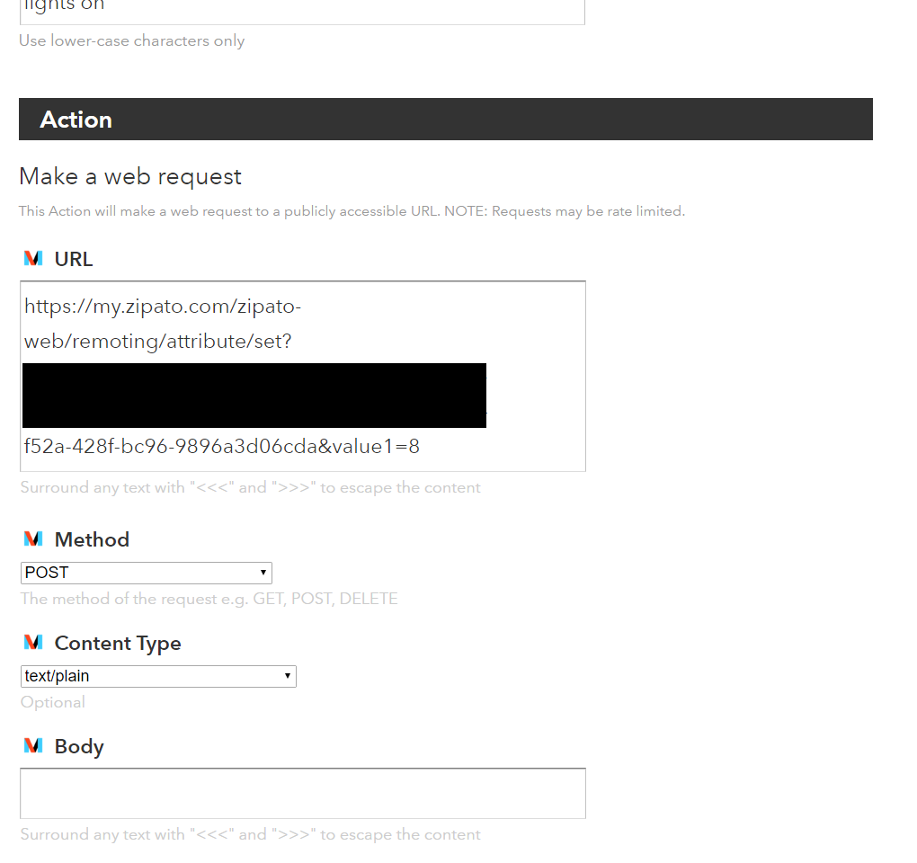

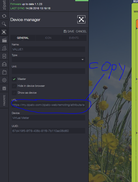

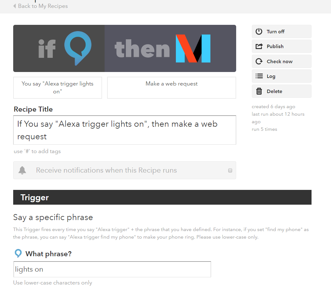

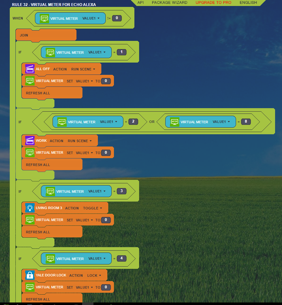

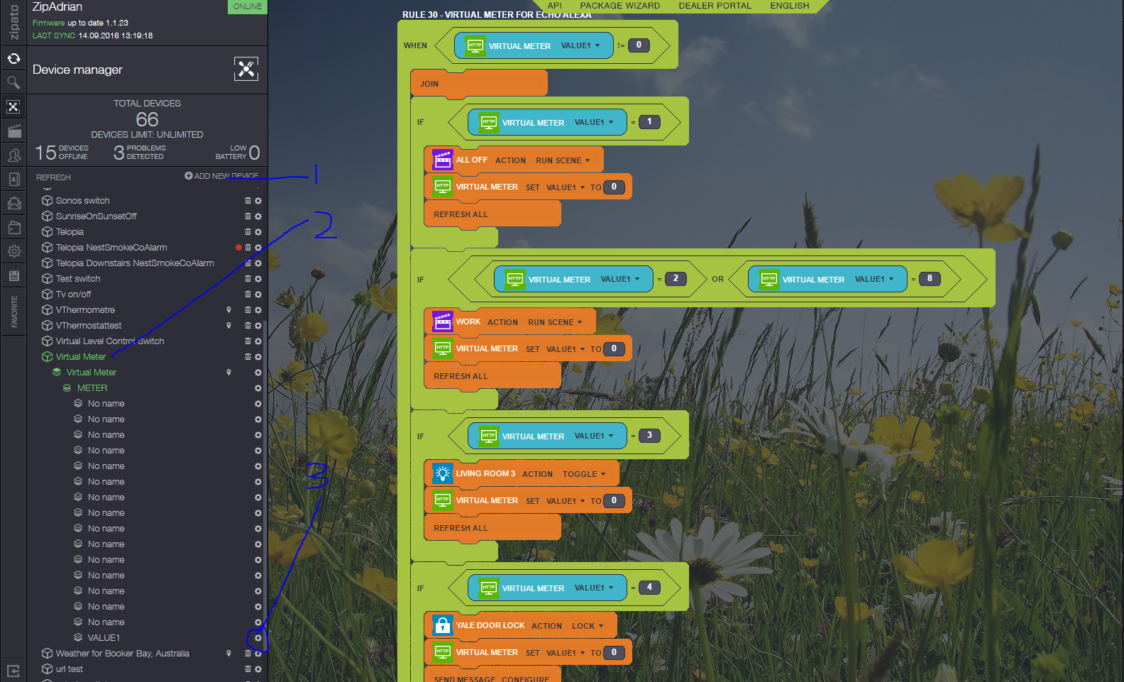

here is a rule of a virtual meter I have been using with IFTTT, Alexa and the Maker channel. This may help someone who is looking to use alexa or google assistant but not with the pre configured voice settings. This will require users to say "Alexa/Echo/Computer(new), trigger, ........whatever you want to say......."
Or if you have the Google Home, use Google Assistant. This is actually better and faster and allows you to custom up to 3 different ways of saying a command, and its response. And you dont need "trigger" But you do have to say "hey google"

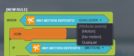

Hi Everyone. Any of you that has tried to make a rule where Zipato needs to "sense" a push and hold of a button/lightswitch?
this would depend on whether your zwave module can distinguish hold from push. What module are you using?

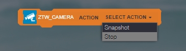

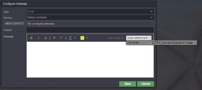

I have an "Indoor IP Camera Zipato" Some time ago she recorded a short video and sent it to my e-mail, I think it's cool!, but this happened by accident, In the rule that camera is included Its function and when the alarm is violated capture some photos and send them to the email, Instead of the photos he recorded a video i found very interesting. I already asked questions for the "@support zipato"and said that it is not possible If it is not possible, then why did my "Indoor IP Camera Zipato" record and send the video via email! I really want to do this, does anyone know or have ever done anything like it?
As far as I know Zipato was having issues with this even with zipatile camera...
I'm not talking about the camera my zipatile, I have an equal to the attachment below!
I know you don't talk about Zipatile camera. What I meant is that this issue is for every camera connected to zipato, as far as I know video snapshot has never worked properly. I will test with the latest beta and see if it works.
Now they even removed the options from the ACTION puzzle and message attachment, before we had the options but it didn't work. At least from Zipatile they even removed the ability of recording videos, only livestream is available. I'm sure they did this for all Zipato cameras.
I really don't like this... they most likely removed these options because of the problems they were having and the fact that never worked. One step backwards Zipato...

Another approch for sending a message when the washingmachine is finished.
3 minutes aftere the variable wasmachine (=washingmachine) the message will be send.
I would be inclided to insert a Join command after the When block to stop executing the washing mashine rule in multiple instances. Otherwise nice rule
Variable wasmachinelast needs to be updated frequently. That is precisely why i didnt choose for a join command.
