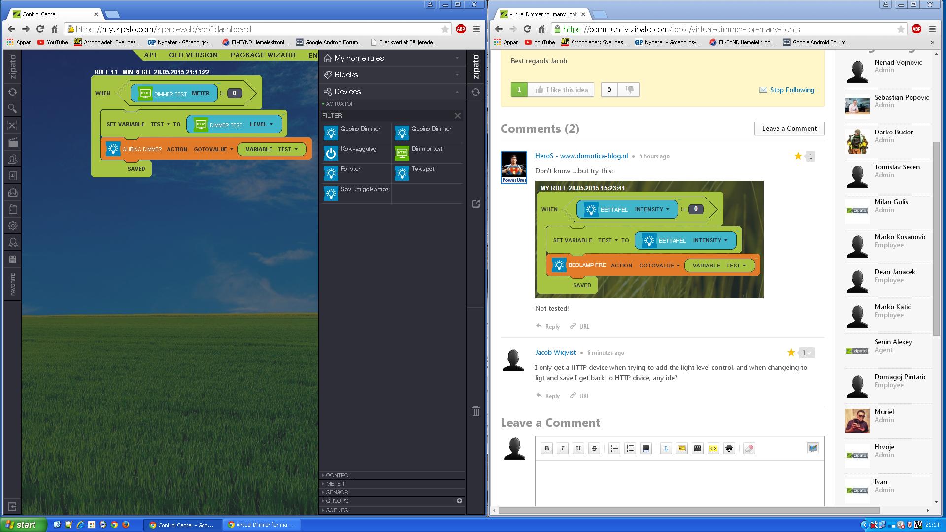

Is there a way to use a Virtual dimmer from the Virtual devices to dim a lot different lights with the same slider?
And if it is not possible is it possible to implement that Zipato?
Users, Zipato?
Best regards Jacob
Replies (4)
Don't know ....but try this:
5c4d5f8c6977513fc9de57846b901283
Not tested!

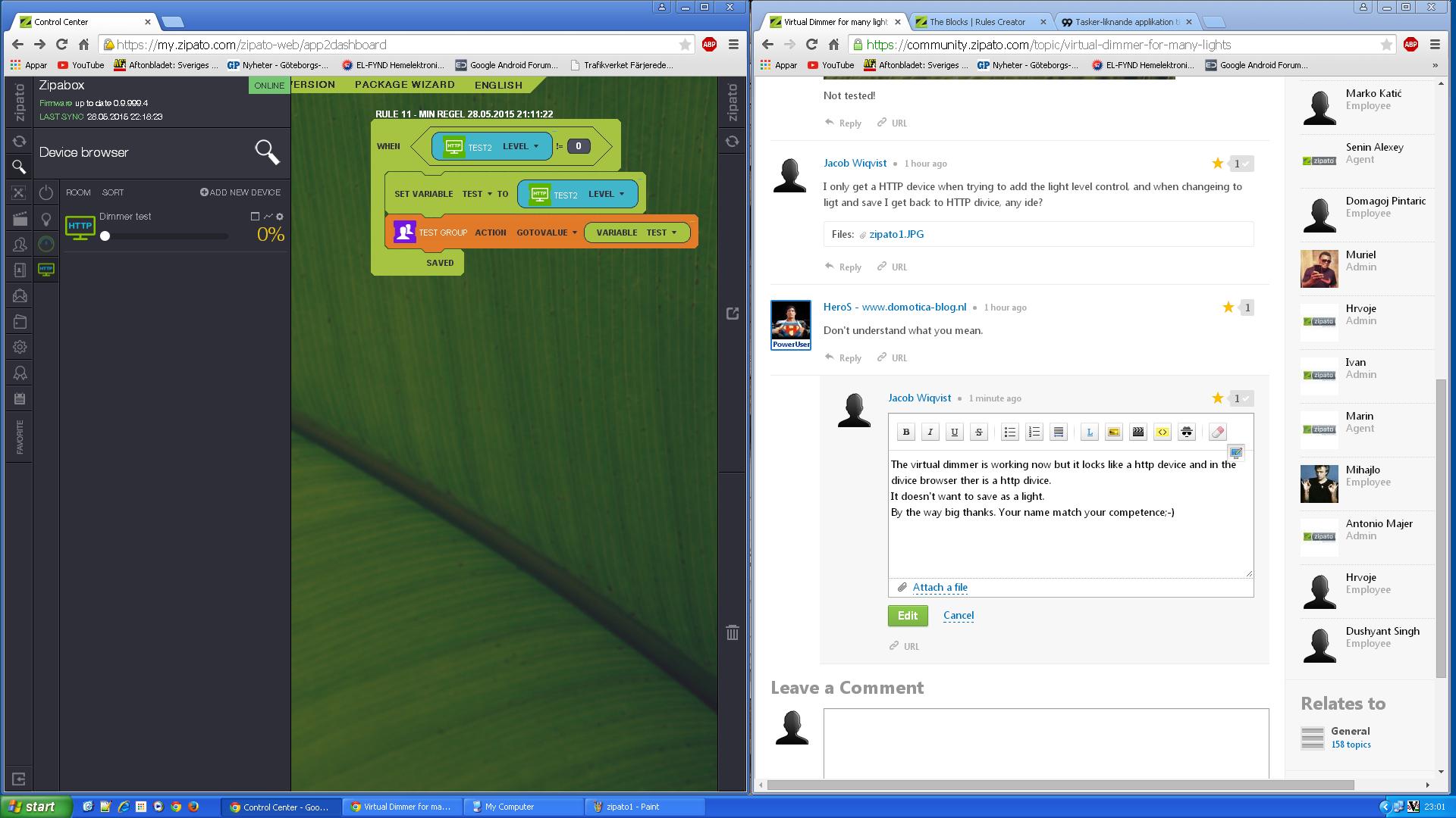

I only get a HTTP device when trying to add the light level control, and when changeing to ligt and save I get back to HTTP divice, any ide?
Don't understand what you mean.
The virtual dimmer is working now but it locks like a http device and in the divice browser ther is a http divice.
It doesn't want to save as a light.
By the way big thanks. Your name match your competence;-)
291c6c3a995ae99e9763ff0727b0f1c9
b424bf4234be8bd88e2902adfa3d14b1
Great that's working,
Don't think it is possible to change it to a light. But what happens when you put it on light?
It is possible but i think it is a Zipato thing, with the home page and how it updates?
