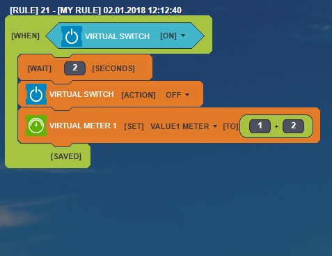

Make rule like this in picture:
Result: Virtual meter is not updating..

I added this delay to all my rules IFTTT / Google home, otherwise the sensors do not update. For example, in your rule, the sensor will go OFF before it has been set to ON and remains ON. I do not know if I'm very clear

I tested your simple rule and it works just fine, the only difference is I didn't use an operator since the "Value1" needs a clean integer value and not an arithmetic value "1+2", which in this case is a 3 but still how you send the value is from the ruleset still different.
