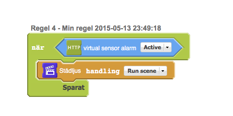

I have a google calendar event to set a HTTP virtual sensor to ACTIVE with the help of IFTTT.
Then I have a rule that:
IF http sensor ACTIVE
run scene "all lights on".
This works the first time. But I have to manually send a http command to set the rule to INACTIVE every time to reset it.
How do I create a rule to do this?
Skärmklipp 2015...
Just use the set puzzle.
>> action >> Second puzzle >> add virtual sensor >> False
