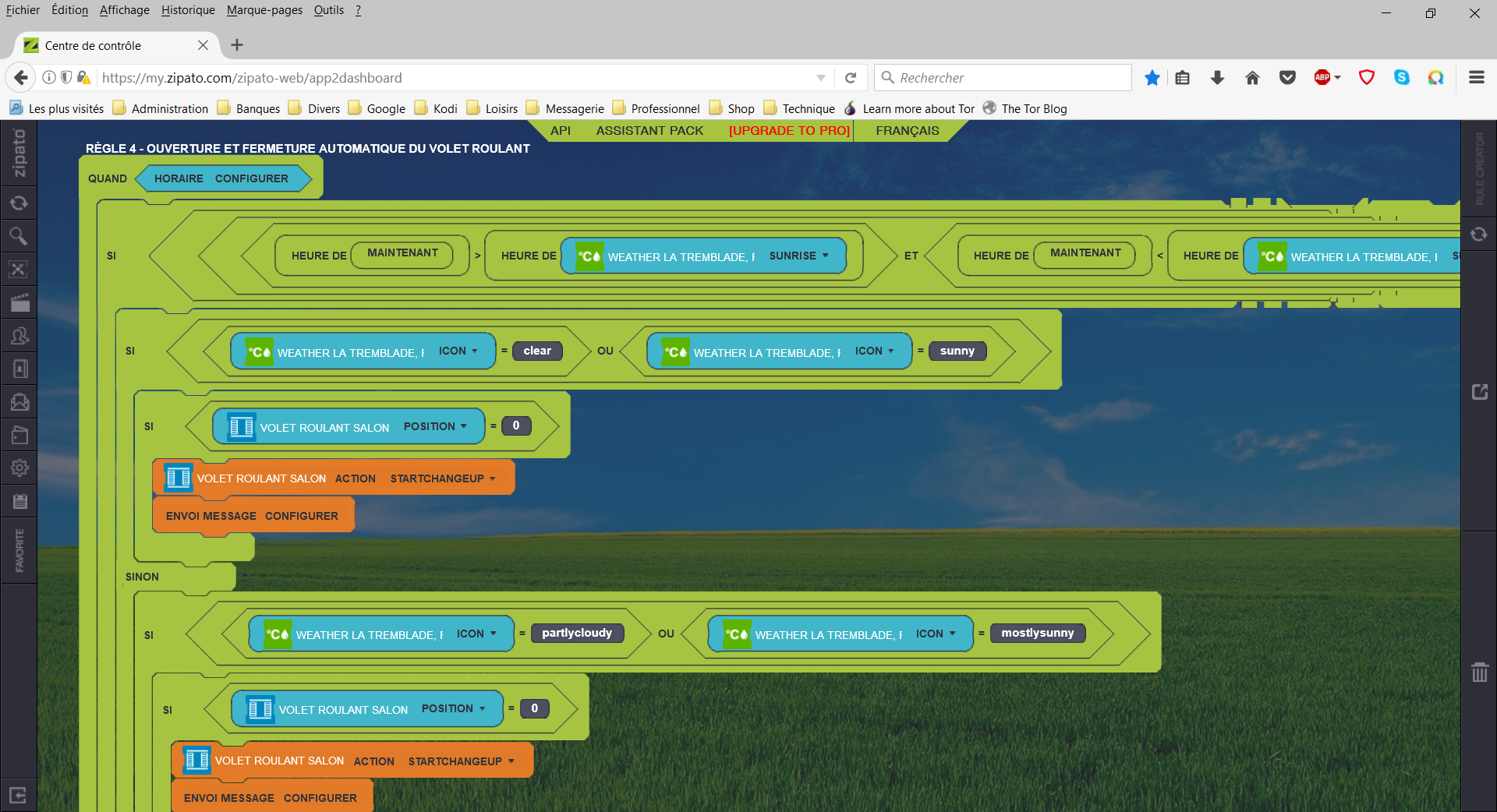

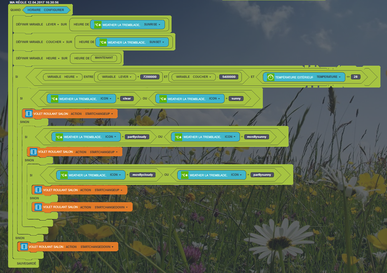

The icon of the Virtual Weather Station changes, depending on cloudiness. Is there no possibility to access that information via a rule? It would be so convenient...
I use this capabilitie to manage my roller-shutter.
Here is an extract of this rule.
You will find the entire list of icons on the Weather Underground site
BR
Michel
Files: Rule.PNG
Excellent! Thank you.
BTW: Link to Underground site: https://www.wunderground.com/weather/api/d/docs?d=resources/phrase-glossary
You can do string comparisons now??! Since when?!
I swear that didn't used to work!
I can just tell you that I use this rule since 2 months and it works fine. So, I swear that do work now.
My roller-shutter open and close depending the sunrise and sunset and cloudiness.
I'll probably add this summer a condition linked to the temperature.
BR

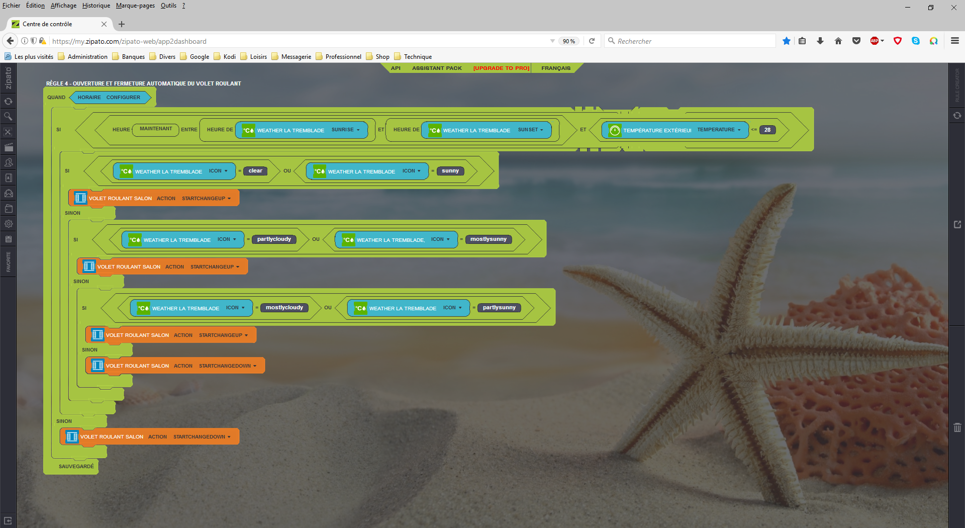

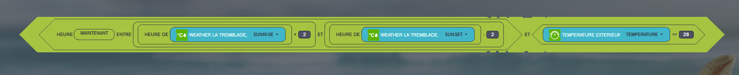

BTW, here is my rule as a whole including the temperature parameter.
For details, here are the explanations:
If I am between sunrise et sunset and the temperature lower than 28°C
If the cloudiness is sunny, clear, partlycloudy, mostlycloudy, partlysunny or mostlysunny I open the roller. Else, I close it.
The only thing I can't do is to differate the operations 2 hours after the sunrise et before the sunset.
If you have any idea, I'll appreciate your help.
BR
Last point, it will be more simple to have the "select case" instruction.

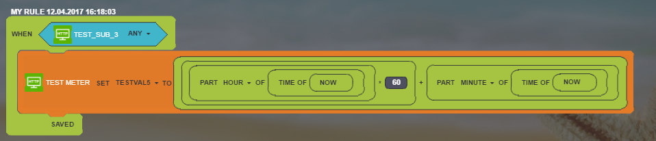

The time value of sunset/sunrise (like any "time of" value) is basically a number representing the number of milliseconds since midnight according to GMT.
I stored the following times in variables and sent them to myself in an email:
13:00: 43200000
15:00: 50400000
If you work it out, they correspond to 12:00 and 14:00 (i.e. GMT), expressed as milliseconds since midnight.
Now, I don't know whether you could add 3600000 (2 hours in ms) to sunrise/sunset and compare that to a given time. MAYBE. I would try time of (sunset) + 3600000. That's an interesting experiment. The sunset/sunrise values in the weather station are strings, I think, like 19:30. The time of () value is a number. That's why you can do: time of (14:05) and it will work.
But what my rule does is extract the minutes and do all the calculations with those.
I've just tried it out and it doesn't work. The Zipabox doesn't currently support "casting" from a number value to a date/time value. Only from string (19:00) to date/time. So you can extract numbers from date/time values, but that's it, you have to stick to numbers. There's no way to get back to date/time.
Here's a suggestion. Create a date-time meter to store the total number of minutes since midnight. Have a rule run every minute or 10 minutes to calculate the value (by extracting the hours and minutes using "part of"). Also have the rule store the same value for sunset and sunrise in that date-time meter, using the same method. Then you have two values which you can compare.
I like this method so much, I may use it myself!
You can do something similar with the date-time, but it's more complicated. The function to work out the number of seconds since 1/1/1970 would be rather complex. What I do is have a Google App Script take the Unix date value as a number and send it to a virtual meter in the Zipabox. It runs every ten minutes. Another complication is that the meter values don't have the precision to hold such large numbers, so you have to express it in hours.
I have a post on this somewhere!

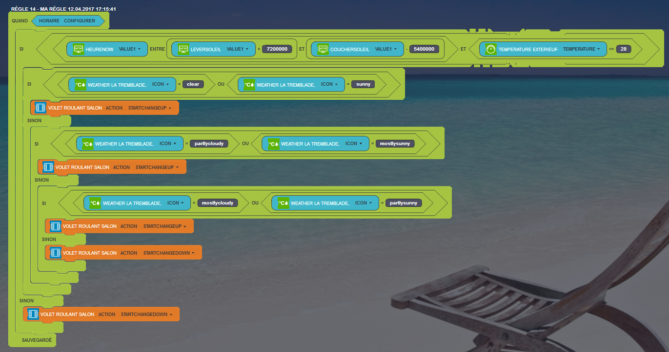

What do you think of a such rule? I don't know if it's work but it's more simple.
As I have not a PRO licence, I can't send me the values through a mail.

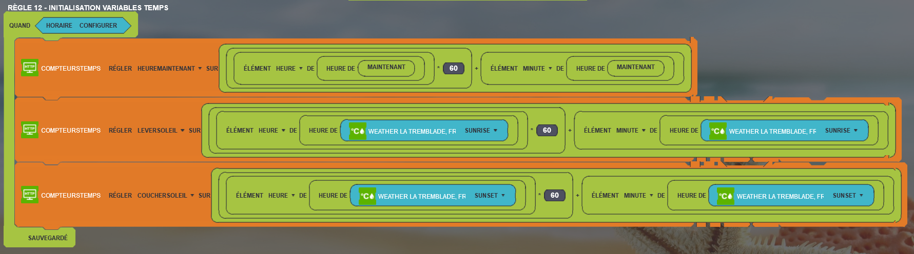

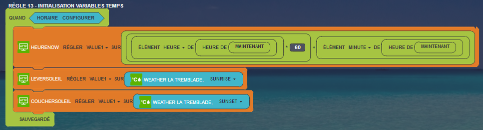

Finally, I followed your advice and wrote 2 rules.
First, to initialize the time variables.
The second one, which manages rolling shutters.
Unfortunately, it does'nt work.
Do you have any idea why it does'nt work?

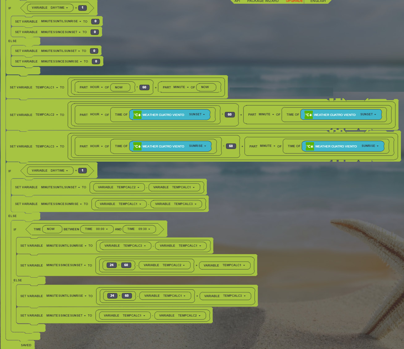

Michel, you need a couple of changes. First, do the same with the sunset/sunrise values as with the time, i.e.
set value1 = part hour of (time of (sunset)) * 60 etc etc
Then what you have are three values which are minutes. So all you need to do to add or subtract, say, 1 hour, is add 60 or subtract 60 (not the larger numbers, which were milliseconds).
Also, for tidiness, and to reduce resource use, you could put all the values into one meter, rather than using a separate meter for each one. Just rename the attributes of the meter.

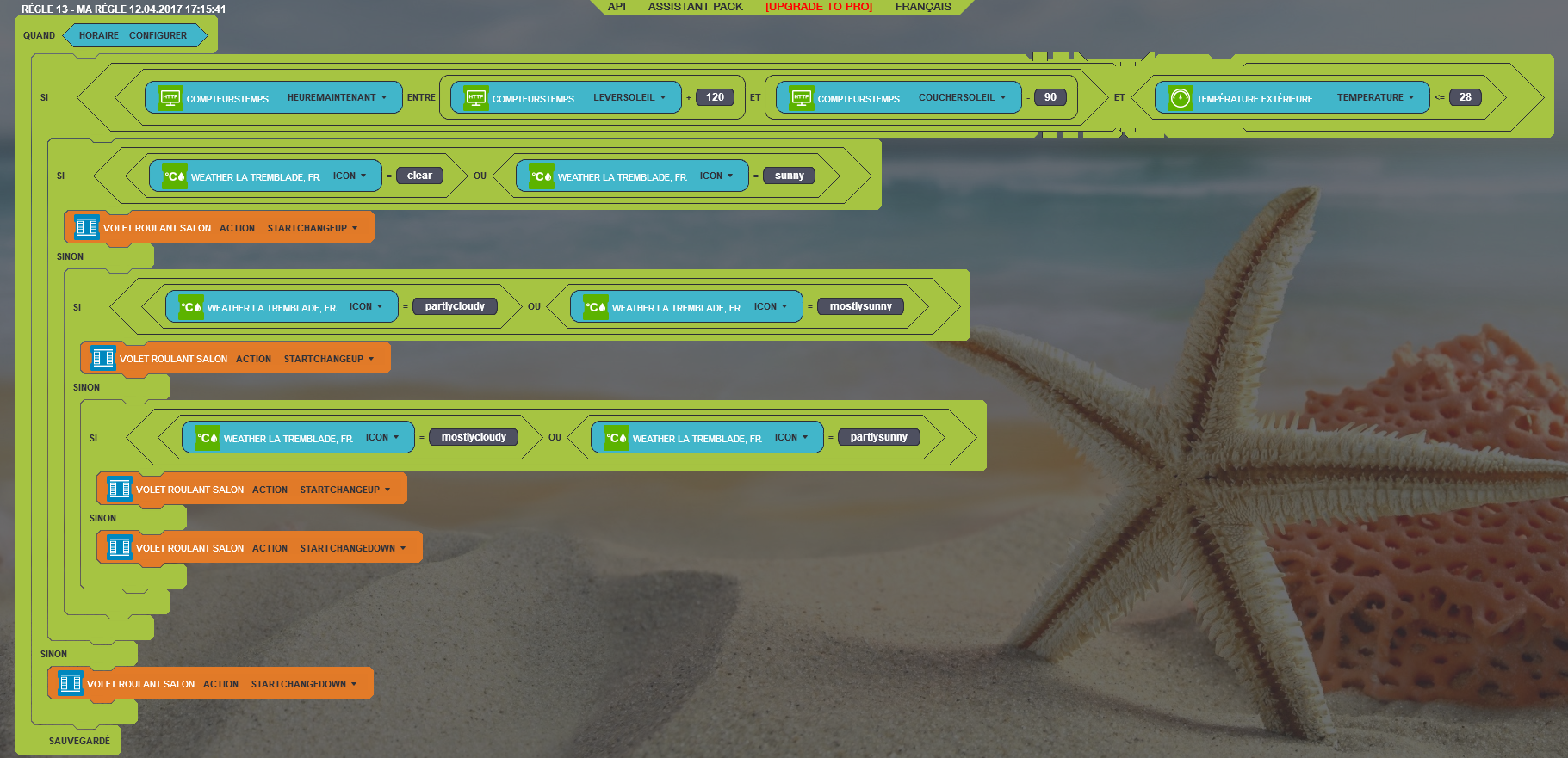

Good evening,
I changed my rules according to your recommendations.
It seems that it works at least to close the shutters roller tonight.
I would see how it works tomorrow. If there is a problem, I would like to contact you.
In the meantime, thank you for your help.
I enclose the rewritten rules
BR
Looks good! Excellent.
Sure, no problem.
@David
This morning, with these new rules, my rolling shutters opened normally.
It seems to me that it works.
I find this source coding very clever and very convenient.
Again, thank you for your help.
BR

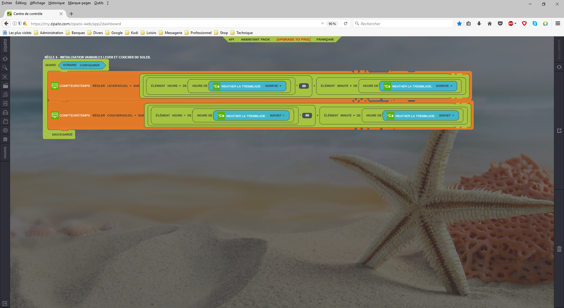

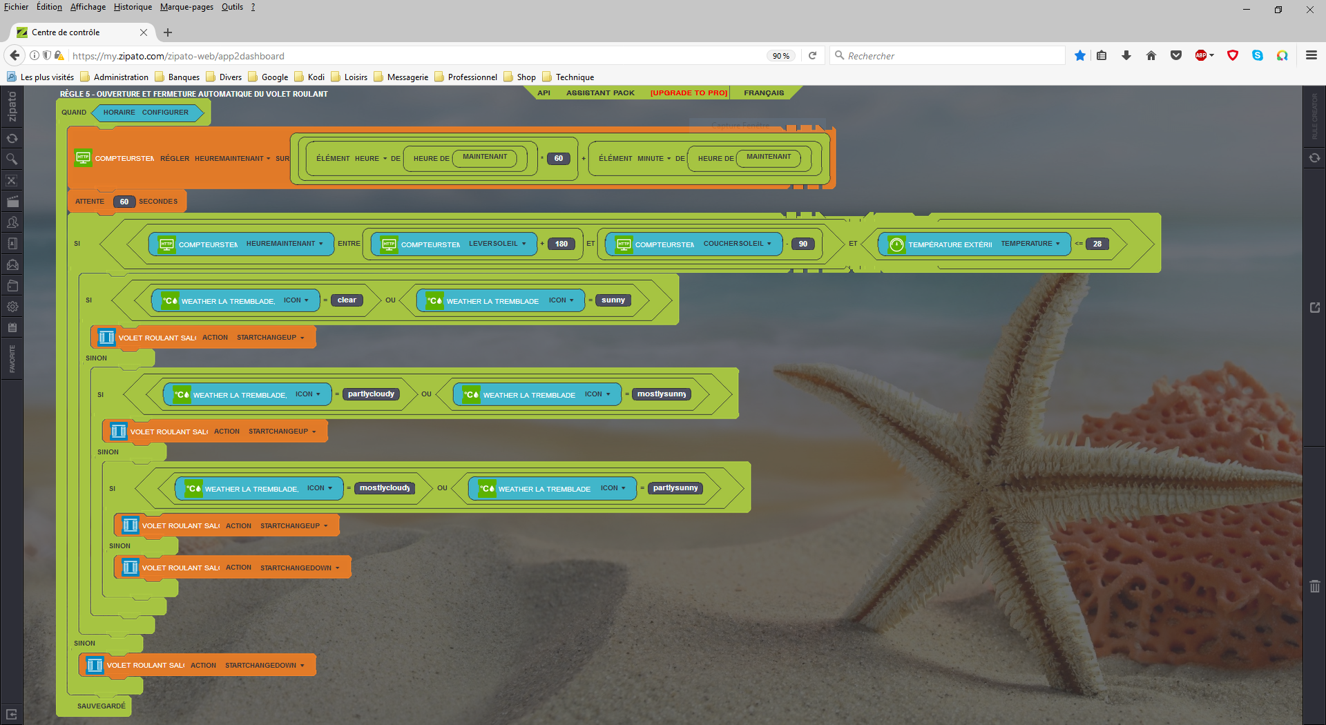

To close this conversation, I have improved the rules because it was ridiculous to modify the variables each 5 mn.
In fact, I initialize the variables sunset et sunrise once a day, and the variable timecounter each time I execute the rule wich verify if I have to open or close the shutter-roller.
I join the rules to this post.
br

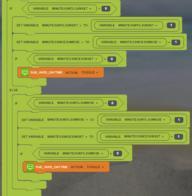

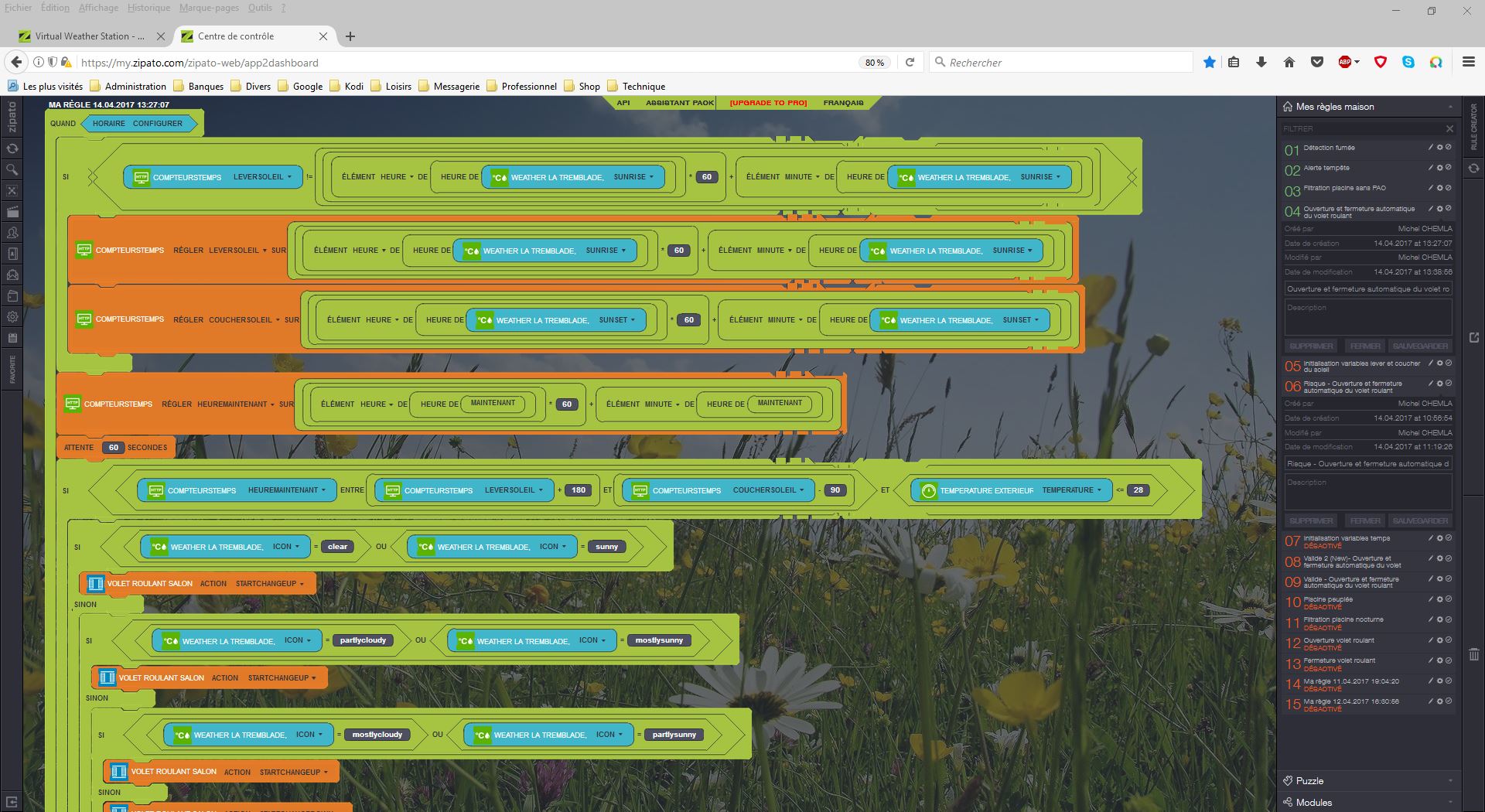

Finally, I fix this problem by creating only one rule. It is less clever but more effective.
With the rule
That looks like it should work! An auto-correcting rule, as it were.
