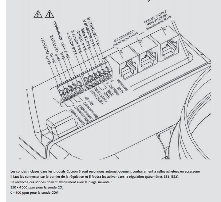

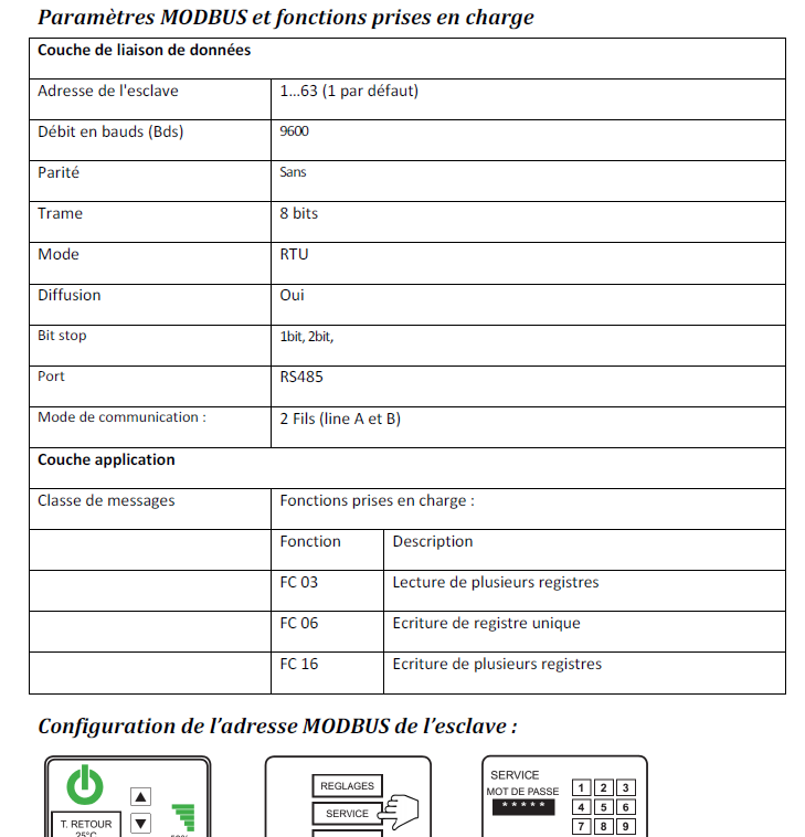

see the attach file :-)

I've found this topic. I've also a Cocoon 3 (25) VMC with KTS basic.
I would like to build a modbus because their is so expensive and I also preparing to change fans to have the 55 ariflow.

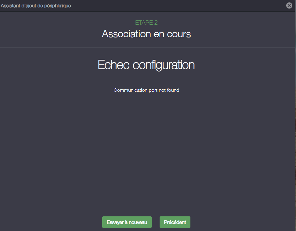

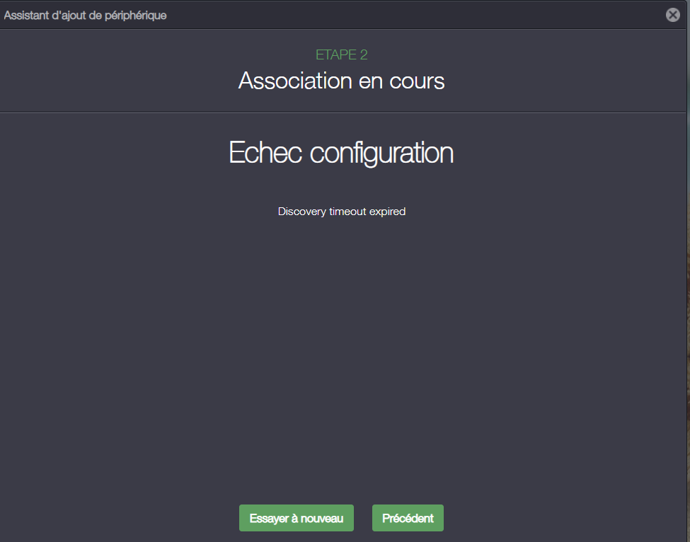

Not yet Sulu,

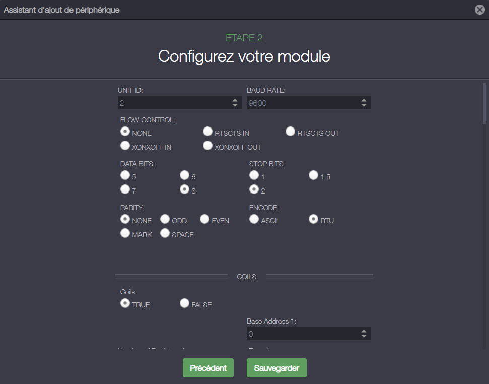

i Try it in RS 485 with serial module, buttttttt....... :-s
do you try by create a module in RS485 => generic module, the support tell me to try this with lastest beta version FW
