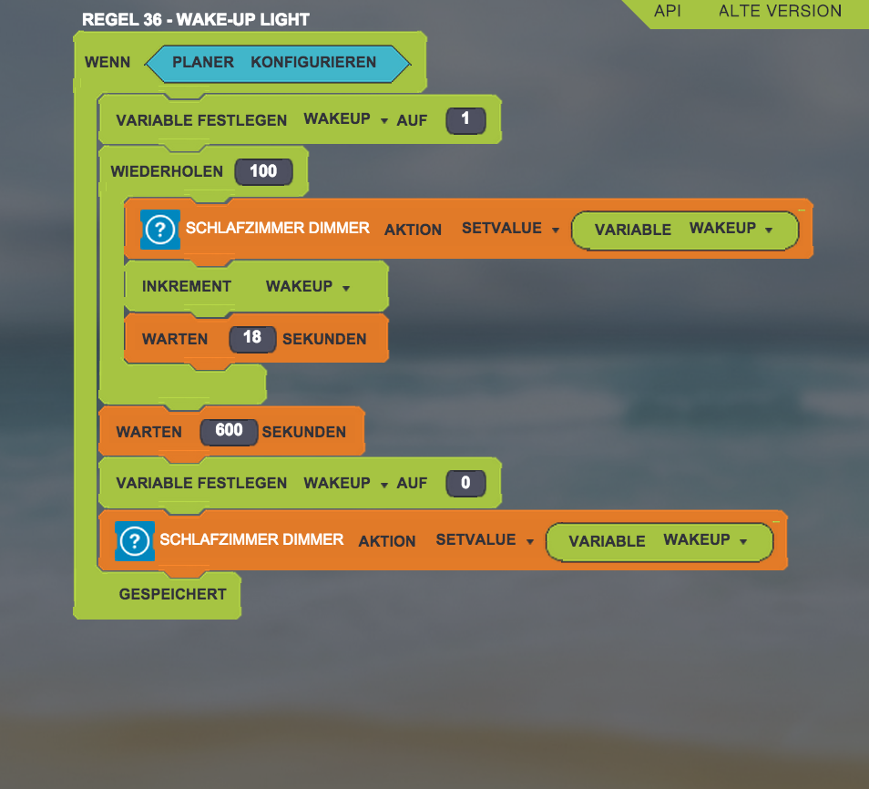

Had a similar setup with a Popp-Dimmer. Triggered by a schedule the intensity is increased from 1 to 100 in 30min. then intensity stay at 100 for 10min. before turning off.
