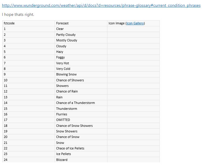

For those interested, here is what I found in attachment
