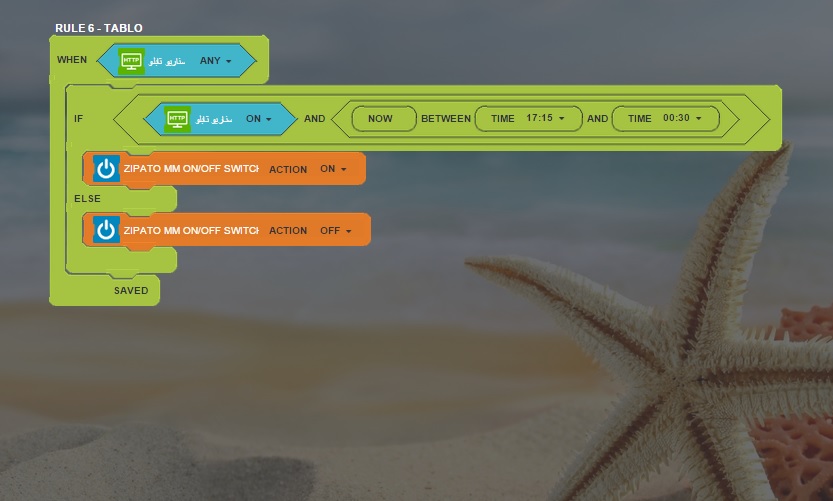

what is my problem ! for create rule with time
ReMi shared this question 11 years ago
hi
I need turn on my light between times 17:15 and 00:30
but I can't . this is my rule (attach file) . where is my problem in rule ?
please help me to create a correct rule .

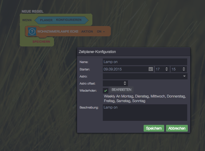

to switch the Light on, i just created a rule for you.
regards Helle
Hi , thank you Mr Helle for answer me .
this is for switch the light on . for switch the light off after the 07':15" I have to make a new rule ?
can I make just one rule ? with a virtual device (on/off) and variable .... ? similar to my attach file ?
for example IF virtual device is on AND time is NOW between 17:15 and 00:30 ~~> light goto on ELSE light goto off .
is there one rule for me ? or I should just use two rule ?

the best solution is to use 2 rules for this, because you can use the planer as trigger.
regards Helle
