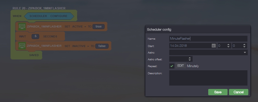

Sorry for my delayed answer. Yes, for me started very simple, using two rules as follows;
1. A scheduler that activates a virtual sensor, waits for a few seconds and then deactivates it.

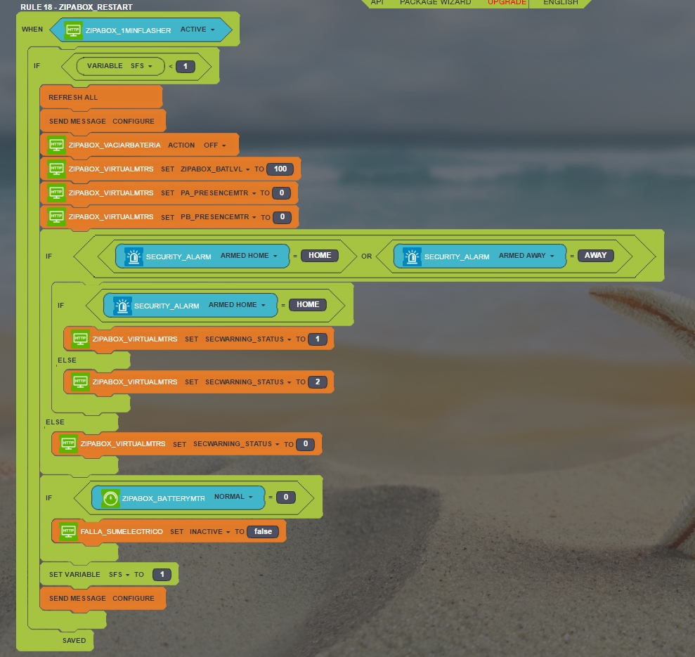

2. Rule that is activated when this virtual sensor is active and if the variable (in my case SFS) is less than 1 then it runs and recalculates what I need.
After a few months my rule number 2 started to be very long so I decided to split it in two rules, and then with some issues that firmware upgrades caused to my zipabox I decided to make a 5 repetition reboot housekeeping.
1. Rule 1 same as above
2. Rule 2 runs when variable is less than 1 and minute flasher active, do some stuff and set value 1 to SFS.

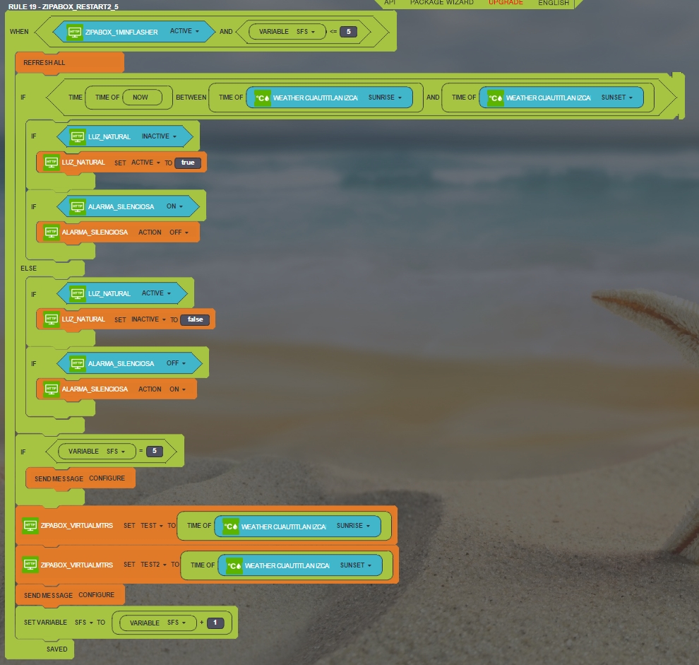

3. Rule 3 runs when variable is from 2 to 5 and minute flasher active, do some stuff and increments value by 1.
