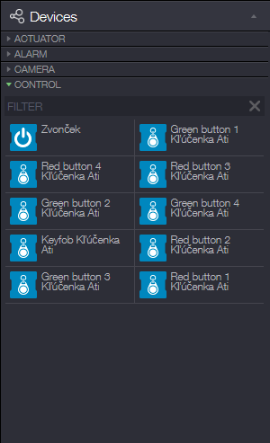

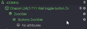

This is how it shows in my system. I actually deleted it from the device browser as you cannot do anything with it, fron device browser. It is useful for rules...

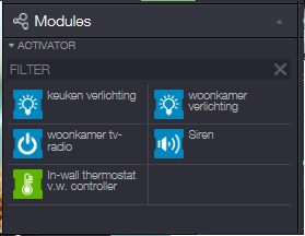

what kind of device is it showing in your module manager?
In mine it says on/off switch
it looks like mine but it is not in my rule creator.
i don't know why but let me ask.
Hi, It is not an onoff switch. It is a wall toggle button. If included correctly, in the rule creator it should be in Control (like a remote controller). Mine is labelled as "Zvoncek".
