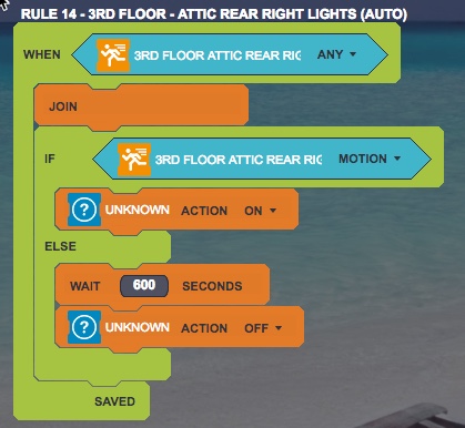

I just had one of my Aeon Micro Switch G2 v2 in wall switch automatically removed from the z-wave network.
All the related rules became invalid. I opened a ticket few minutes ago, let's see what zipato say.

Again today - added new actors to the z-wave network and again other actors got dropped for no apparent reason. It seems the issue still persists. So annoying!
rules are broken and adding the actor back in the network is always a pain as it need to located / disassembled from the installation and then rejoined. Once that is done you can start fixing your rules.
worst part of it is, the rules are now broken so you never know if the automation is still working or the whole execution of the rules seize to function.
To track the actors i started labeling them all with an identification code which is stored in the website (name). When 1 is lost i can find it because there is a gap in the numbering, dig up the blue prints of the electrical system and find the damn thing.
@Support; When is this getting fixed!
