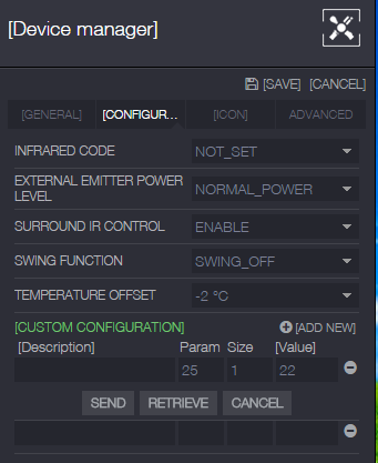

I have a z-wave zxt-120 IR extender. it wont save more than one custom configuration parameter in the layout. (its working ok, and sends the command and everything)
So it is not doing anything when clicking on "add new"? What is this config parameter for? I dont even know how the custom configuration works...unable to find any info on it.

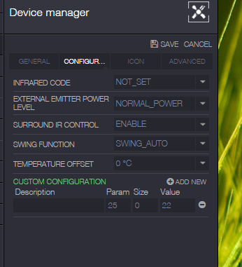

Either way my system seems to be slightly different. What firmware are you using? See printscreen.
Yes, but when i named it, and click save, and syncronize it goes back to only one custom parameter.
With the zxt-120 IR extender, i have to learn all the IR codes under parameter 25 (value1-22). It is to set up the device settings that is not under the standard setup by zipabox (infrared code, surround ir controll... that is also a parameter with a parameter number under). The parameters on each device is described in the manual of the devices.

Any solution found to this problem?
I have the exact same situation with only the last custom configuration visible.
