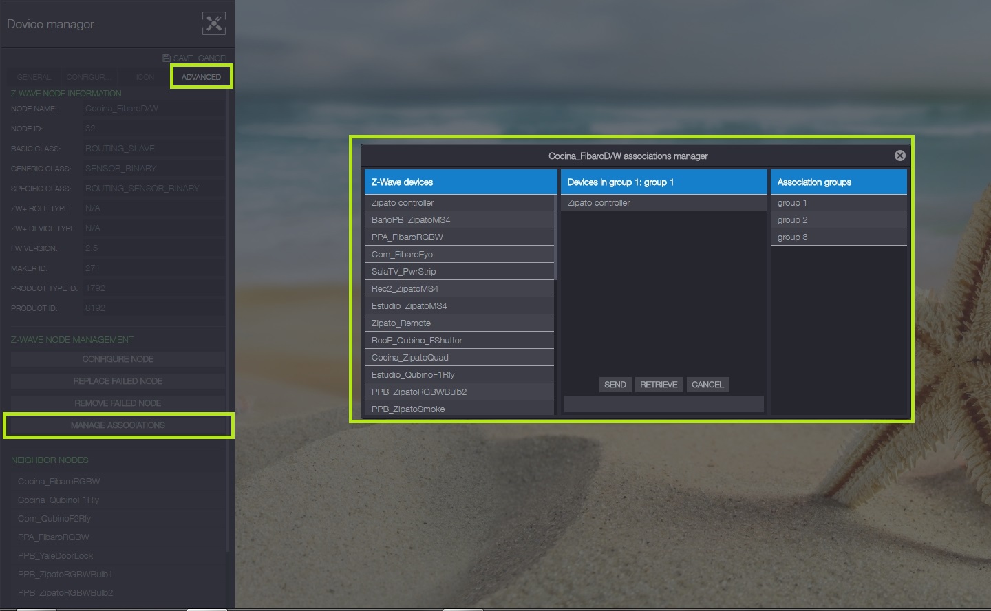

In the control center I go to the Module Manager, select the properties of the dimmer, go to the advanced tab and click Manage Associations. There I select Group 4 (On/Off S2) and drag the Wall plug to the middle list and click send.

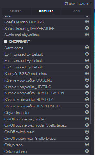

Double check the success of sending by clicking retrieve.

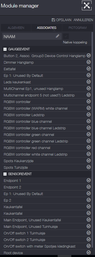

Also, you can check if the two are neatively connected if you open up the setting for group 4 of the dimmer and then in the tab binding. The right line should be in green and marked also as native.
Im unable to show how its supposed to be as I dont have any native bindings done, but you should have the binding shown

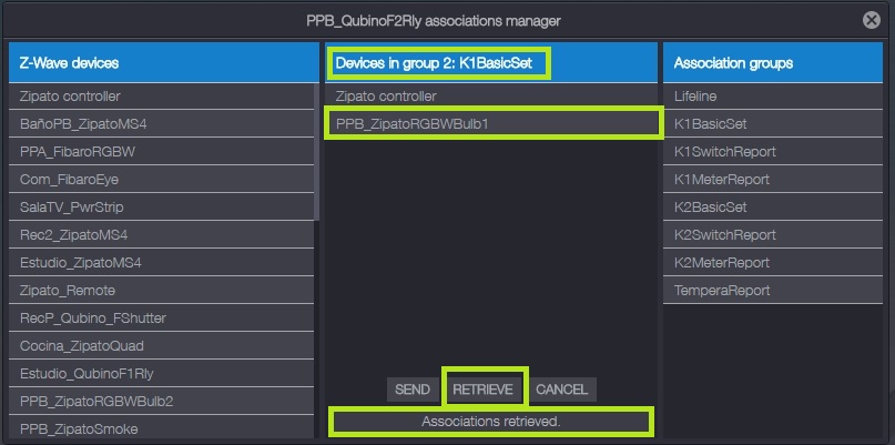

When I click retreive it shows it correctly, so it seems it is written to the zwave module.

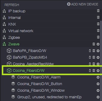

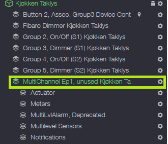

Try to go to one higher level. At some point the bining tab will be full (like mine in the previous message)
You have to pick the main device...
