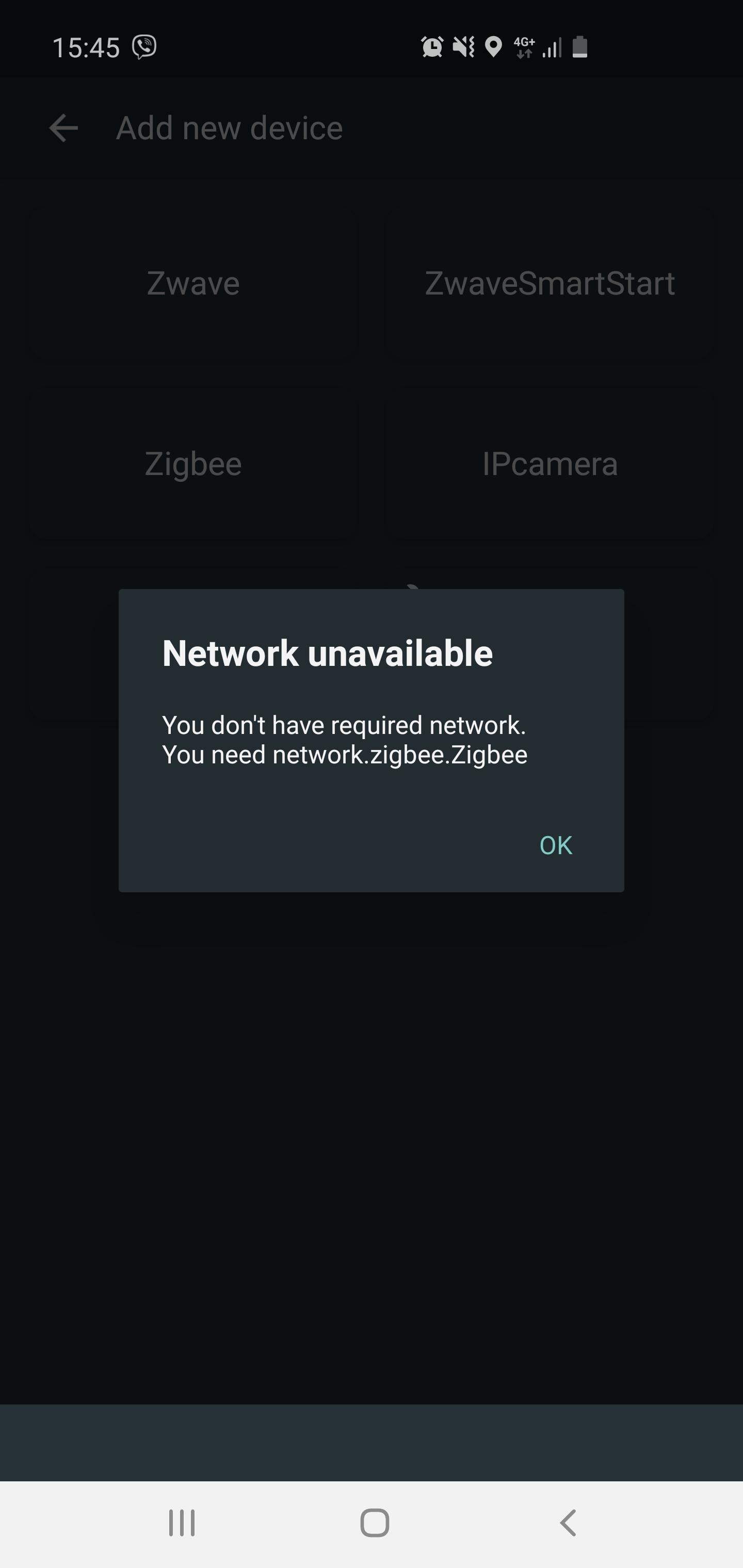

Cant add Zigbee devices. Why?
Added photo :)
Replies (6)
it seems your controller doesn't have Zigbee module.
What do you mean?
Zipatile 2 should work with zigbee
ZipaTile2 doesn't have Zigbee module by default.
Zipatile2 has z-wave and ULE by default.
So, need to buy module or what? Thanks :)
At the moment the only option is to order ZipaBox2 with Zigbee module.
In the next few months it will be available upgrade for ZipaTile2 where you will need to send us your ZipaTile2 for upgrade with Zigbee module.
