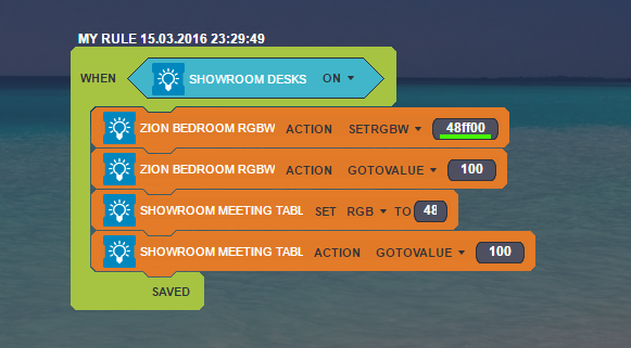

just quickly try something like this. The showroom switch can be a virtual switch, and by setting the rgb of the bulb you can copy this to other bulbs to get the same colour.
