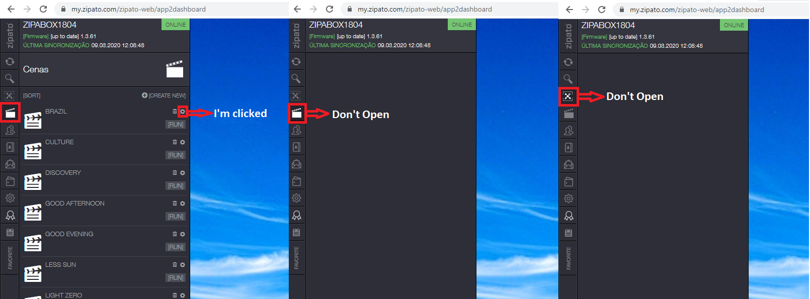

We have a controller that when clicking on scene settings, it no longer shows the scenes.How to solve the problem? We are unable to make any changes.

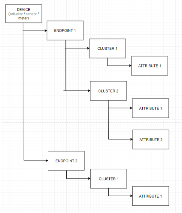

You have a Remotec IR Extender (type-Thermostat) and when you want to see that device in the Device browser you need to use its Endpoint or Cluster.
When you go to the device settings, you need to remove the checkmark from the box "Show as device" and save it.
