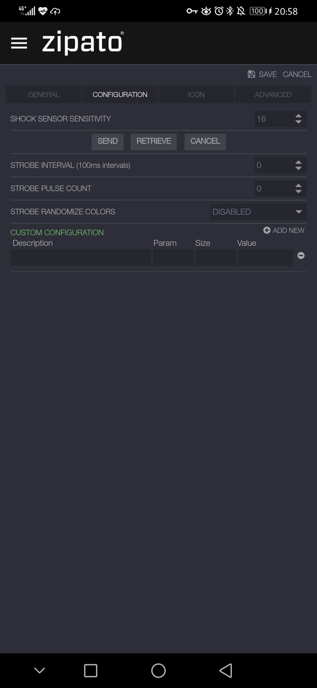

Hi.
I believe you have to do following.
Click the name of the value you want to change.
-->opens buttons to send, retrieve and cancel.
See screenshot attached.
After the change of the value click send.
It depends device's power profile how the change will be received to device (allways on or battery operated). If battery operated, you have to wake device to receive the new value.
