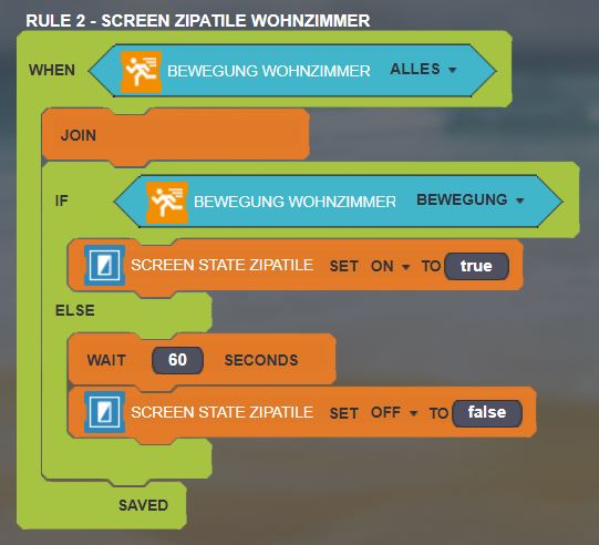

How is that possible now? Didn't find anything in the rules...
/B+LfTTczNF50AAAAAElFTkSuQmCC
Thanks - but I don't have the "Zipatile" nor do I have a "Screen state" in my rule manager...What's wrong? Zipatile also has no firmware or app repo update...
"Zipatile" = Zipatile motion sensor
I think you need to create a ticket and ask customer support to reboot your Zipatile in order to get the internal devices.
For me the device "screen-state" is available since the beginning, I do not remember what firmware, but I have one of the first Zipatile. Maybe it's a single problem and you should contact support.
BTW... thats my rule to activate the Zipatile Screen by motion. The screen is only deactivated when there is no more motion recognized by the motion sensor. You have to deactivate the screen deactivation in the android settings.
