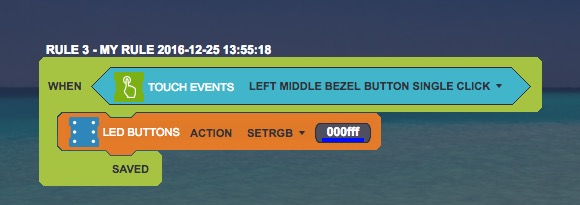

Zipatile Button : How can i set a rule for each button on my zipatile ?
i tried that, and nothing happen (see the attachement)

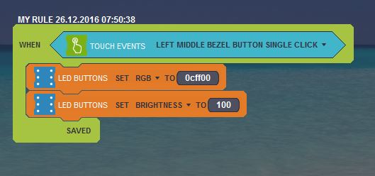

your rule will work only if the LEDs are already ON
so, you need 2 blocks : one to set the color and one to set the brightness
please see attached pic,, it worked for me

weird, i make a rule with timer without the brightness and it works... but not with the buttons... thanks Abdal !
