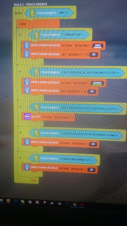

You have to use rule creator to assign button to a scene.
Can you explain it a little bit more accurate. I try it but... fail
you need to go to the web based control centre, and use the puzzles blocks to create a puzzle that when the touch button is pressed, it will activate a scene.
Not the best picture sorry, but you get the idea
Thanks a lot Sebastian, it is clear now.

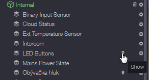

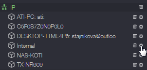

Internal device LED buttons is the one that can be controlled to tun of or to change colours. By defaul it is part of the lights.
Attilla, not sure wht you mean. When i bought zipatile i could see 6 LED dost on the frame, that activate different setting/scenes/lights ets (what ever you wish to set there). But mine are not turned on (no light dot), however yhey still opperate settings as button.
So wondering if there is a setting that turn them off or on, or they are broken already?
See attached printscreens. The buttons represent a device in the web control centre. Have a look. If you dont have it, you will need to enable them via settings. Then you can set dimming level and colour for the buttons. If despite they are not lit up, then it is broken and needs to be replaced which you will need to sort out with Zipato via support.zipato.com
