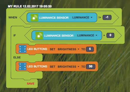

I'm trying to create a simple rule to control de Zipatile buttons light leven according the luminance detected by Zipatile luminance sensor.
The problem is I cannot add luminance sensor inside WHEN <SENSOR> because it appears as a METER, not SENSOR.

try to use the operator != inside the when.
Should be someting like:
when luminance =! 0
action

Thanks m4dt3o. That's the proper way !!
I changed a little bit WHEN comparison to "!= -1"because I think if we keep "=! 0" another rule will be needed in case of 0 lux, right?

right :)
