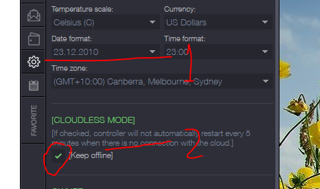

Try to check this CloudlessMode setting see if it changes anything.
6024fe1c8f2384c652d34997ffef37a3
also in your online control center, under settings, tick the box keep offline. This will keep the zipatile from rebooting every few minutes.
If you get stuck that the zipatile can not reboot due to lack of battery, reboot into recovery mode, let the zipatile sit and recharge for a few minutes, then reboot into normal mode.
Thanks, that worked. However, it was a hazzle as that had to be done via the web page which was not reachable as per no network connection. Had to share internet access temporarly through my cell phone to sync the setting to the zipatile.

This is an Android issue. In order to avoid this problem, we have added a small service in the background which is turning on the screen whenever Zipatile losses the connection with the cloud. However, in order to have this service active, you have to go to General settings and:
> SET WIFI as REQUIRED
> SET WIFI as DEFAULT (if you don't use ethernet)
Ok, I've just set it up:
