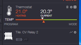

Am i the only one having a lot of problem whit the thermostat function on the Tile??
- - i do not understand the "Heating start at" name tag at the place of the set-point? the description is wrong? my not : Set-point/Heating to.
- I use the Relay 2 to control my heater, i find it often not switching when i chance the set-point manually or when the schedule activates the heating?
Like this temp is dropping and ralay (CV relay2) is not switching...
