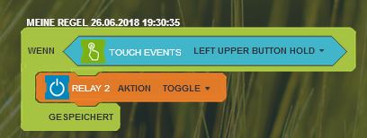

            If configure touch events with touch manager - (button click, ...hold) all is working fine.
But if use it in rule creator - nothing happen.
Tried also without configured buttons in manager - did not help.
What I do wrong?
And how can work a "one finger movement down"? - where I should move the finger - at any place on screen (without the zipato app - or not important)?
Thanks,
Michael
PS: And yes, have synchronized ;)
ok,... I have tried to use the internal relay - but this is not possible.
They are assigned to the thermostat.
Movement is working as expected, buttons too - with Z-Wave Plug ;)
