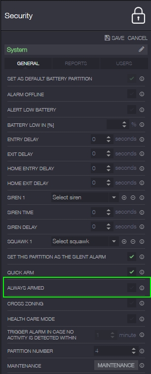

1. If I remember correctly this alarm was configured by default as "always armed", so, no matter what you do you always have this alarm active. If you want to turn it off just go to settings on "SYSTEM" alarm partition, unselect "always armed", save and sync. This way you will actually have to ARM the system if you would like to get the alerts from time to time.

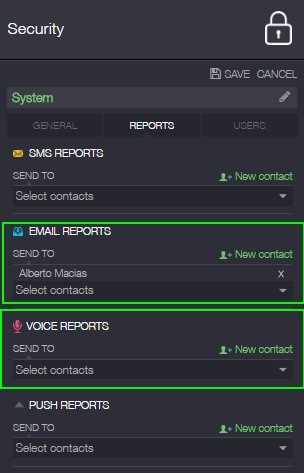

2. You can configure which type of alert you want SMS, email, push and/or voice. Go to the settings of the SYSTEM alarm and go to the tab "reports" you can add or delete any user to any type of alerts. Remember that you need credits for SMS and voice reports.

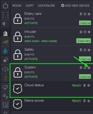

How do you create such "System" alarm?

This is how my settings och system alarm looks like.
Do you have any advice for that?
