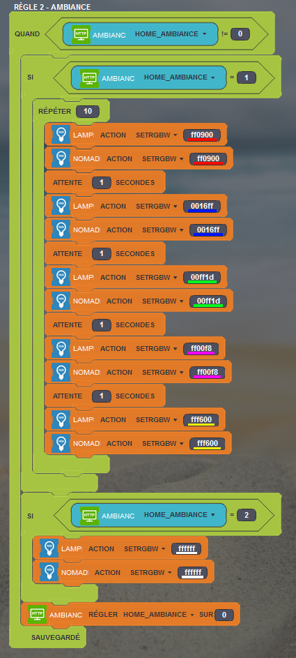

Hello support,
i have configured a lot of rules for my google home and it works perfect.
But i have an issue with some rules, in fact when i try to create a rule for "Party light" my rule work and light is switch from severals colors but during this "Repeat" time i am not able to do another command from google home to my other device wich are not in the same rule.
FOr exemple i say:
"Party Time" to my google home -> Zipato switch my light "perfect" and during this time it's impossible to say " Turn on the light on my bedroom" i have to wait all my rule for party time is finished "Repeat 10" maybe it's just a bad configuration of my rule could you help me ?
And i have another question also for this same rule, when "Party time" is running i am not able top stop it i know it's a configuration error, but i can not find a solution in your KB to create correctly a "Party time light"

Interesting. Rules do run paralell to eachother and if this other light is not part of this rule, than I have no idea why not working. Can you control this other light manually while the rule is running?
One a rule is run, there is no tool to stop it. Unfortunately party time things are not really Zwave favour. Fibaro's RGBW controller allows such, but unfortunately only via FIbaro control center at the moment.
Je vois que tu es francais, donc je vais te répondre en francais, plus facile pour moi.
3 remarques:
- Comme tu utilises un virtual meter, et que Zipato déroule les règles de façon séquentiel, il est normale que tu ne puisses pas relancer cette règle, car elle est en cours.
- Je pense, mais je n'en suis pas sure, que si tu remets ton virtual meter au début de l’exécution, dans ce cas, tu pourras arrêter ta règle avec un "join"
- le plus simple, lorsqu'il y a des actions temporisés, et d'utiliser un autre virtual meter. Si la 1ére régle est ok, elle mets une valeur dans un 2éme virtual meter qui déclenche1871c4d24aeae61251bb28ef81398af4 une autre régle, et donc la 1ére régle étant fini, on peux lancer une autre commande vocale.
- Dernier point, je voix que tu remets la valeur a zéro de ton virtual meter. Je te conseille de le faire avec une requette Http car la méthode que tu utilises ne marche pas toujours, et Zipato ne sais pas pourquoi (et veulent me faire payer pour étudier ce bug)
Dans l'exemple que je met en copie, c'est la règle 8 qui était trop longue (attente de 2 minutes quand je quitte mon domicile), et je l'ai donc délégué à une autre règle.

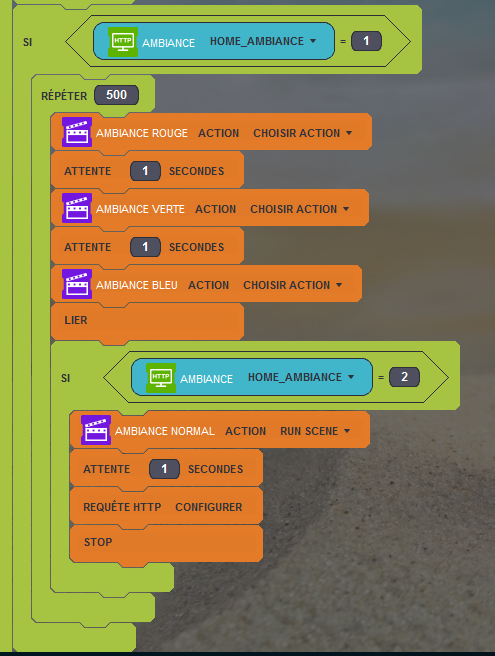

I have performed some modifications on my rules.
My "Party Time" for playing with my light colors works great but i still have an "issue" when i try to stop my "Repeat"
As you can see in my screenshot, ( Im using Google Home with IFTTT and zipato virtual meter to set my values )
My loop works fine, when i say to google to stop my "Party Time" My request is received by my zipabox as i can see on my event logs for my virtual meter. It seems that my rule is entering into my "IF" for value = "2" because when i have a look to my event logs again i can see that my http request is correctly announced by my action on this same "IF".
So at this point, why my "Repeat" still work ?
Another point that look strange, in fact, after sending my "stop request" using value = "2" it seems that sometimes it "works" in another word i am able to stop my rule without "problem" just big latencies. FYI Latencies are not introduced by my network, i already checked it :)
Can someone give me a tips or an explaination ?
Put a join at the beginning of the rule.
I agree
