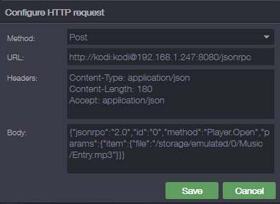

I'm using an old Android phone with Kodi installed for different notifications.
It can be controlled with HTTP Requests in the ruels.
