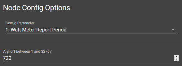

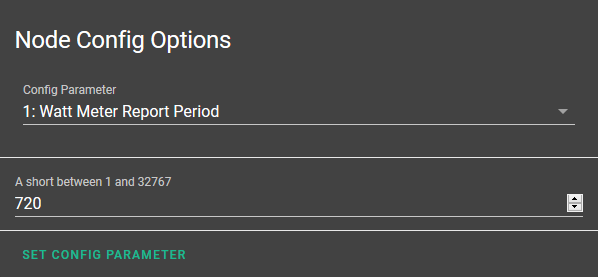

mine is currently configured to 720 as per below
but I am getting reading every few seconds
I dont know what is wrong exactly

Interesting. I'm using a Zipatile. Does your controller have an option to retrieve the register value for option #1? I see you have it set to 720 but are you able to read the register value to insure that it is set to 720? What controller are you using? It could be that the controller is polling the device instead of waiting on the report.
