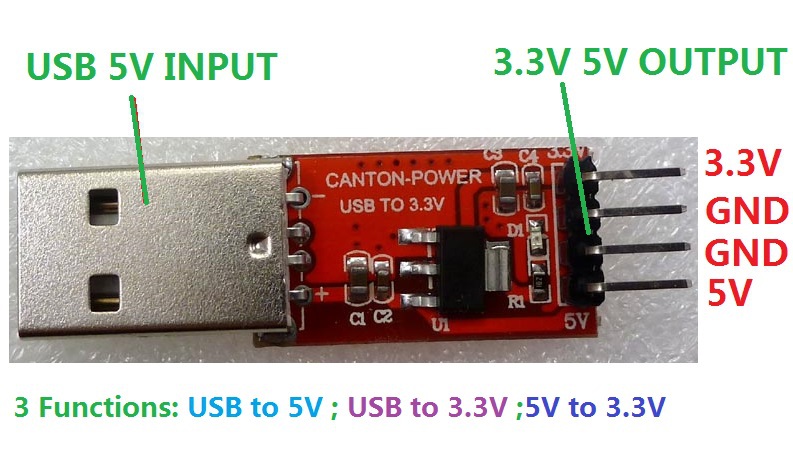

Update here. The RFID reader works on powered 3V without issues. If you plan to power it ensure that the 3V downgrade will be at the RFID side of the wall, not on the other end of the lead as over a couple of meter distance 3V drops down fairly much and I guess this can be a problem. We are running 5V from the transformer (about 7m away) and in the RFID reader placed this small 3V inverted or what. It just fits inside of the battery slot.

Something like this. Search for 5v to 3.3v inventer
