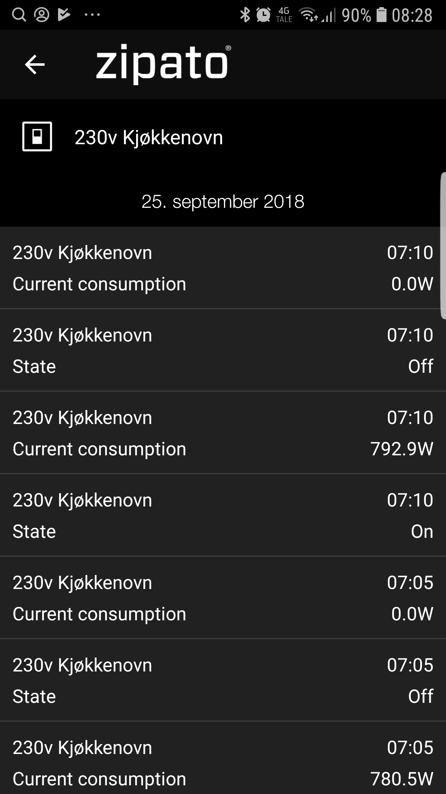

Hello again. Any news on this? The house is werry cold becorse of this. I need å fix.
This is a log from today showing the divice going on, off, on off in a heating periode.

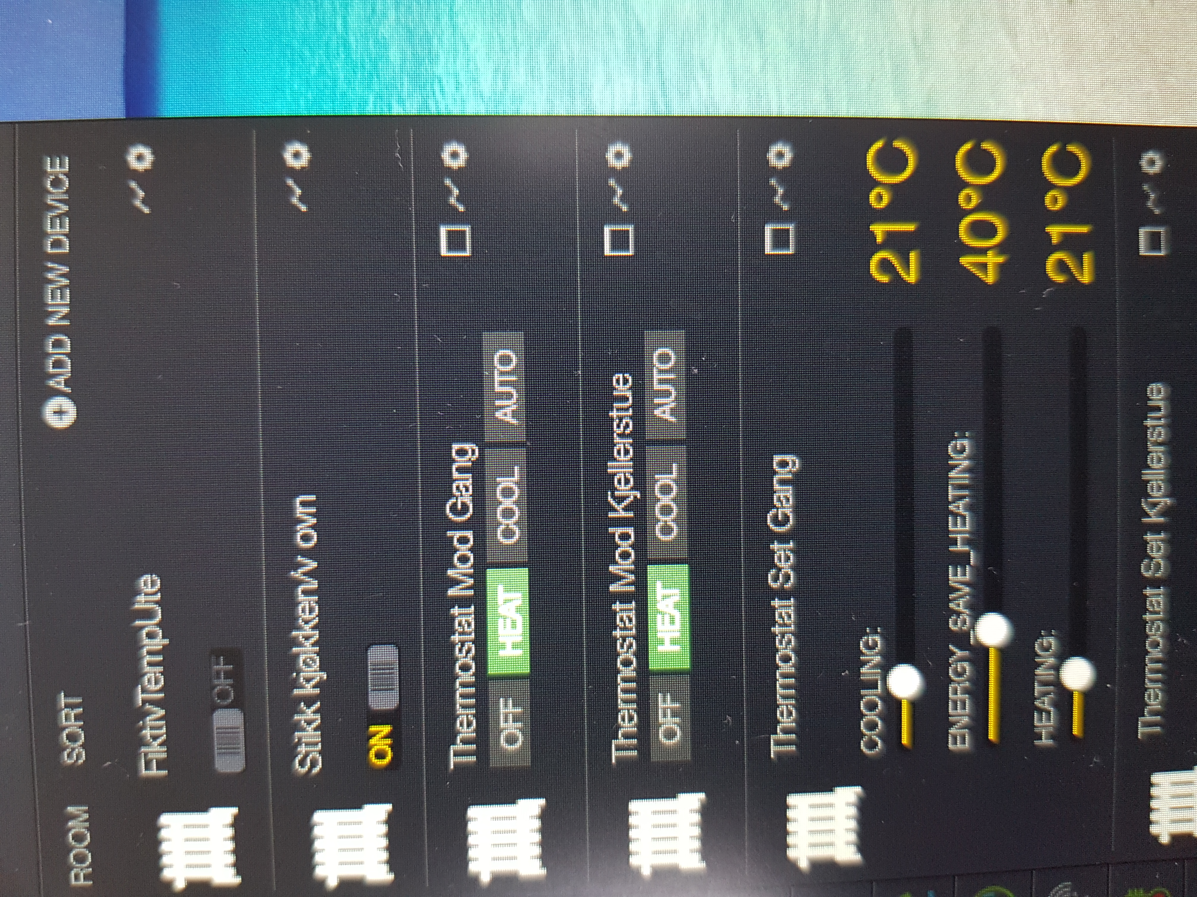

Im using external divices. Its not the divices that is the problem. The zipato viritual thermostat go from heat to off, heat again and off, and so on. Im starting to wonder if this has something to do with the energy save heating funksjon in thermostat settings? Its doing this to save power? I tried to sett this meter to 40c but the result is just the same.

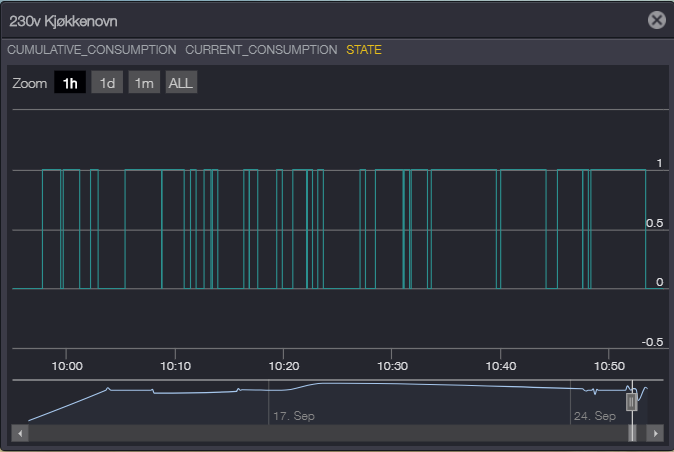

Here you can se the state of the heat divice and the temp i the room at the same time.
Viritual thermostat is set to heat to 21c.
The heating starts at 04:00 in the morning. In my head the heating divice should go from off to on at 4am (If temp is under 21c) and stay on until the temperature is 21c. Then turn off. Right???
