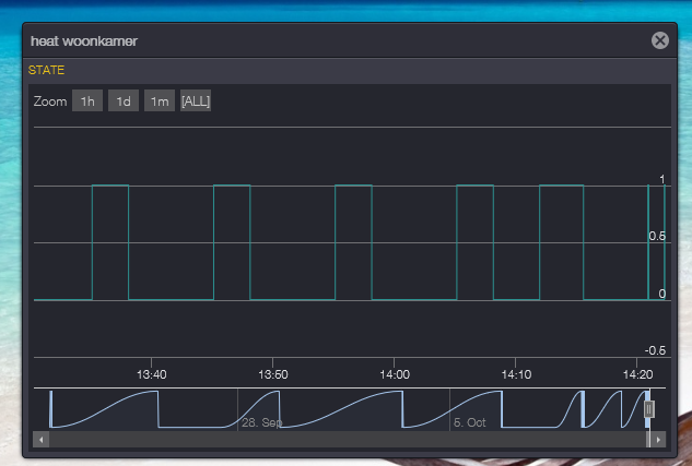

I got a problem with the Zipato virtual Thermostat pro. When the temperature is set to 20.1 it stops heating long before it retches the set temperature. Why does it do that

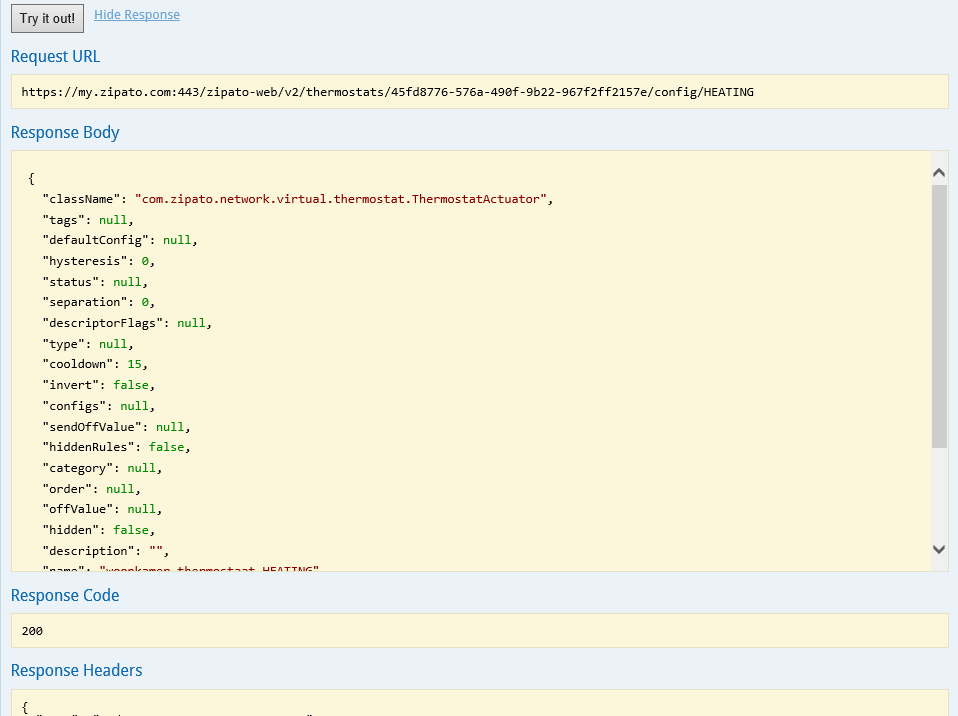

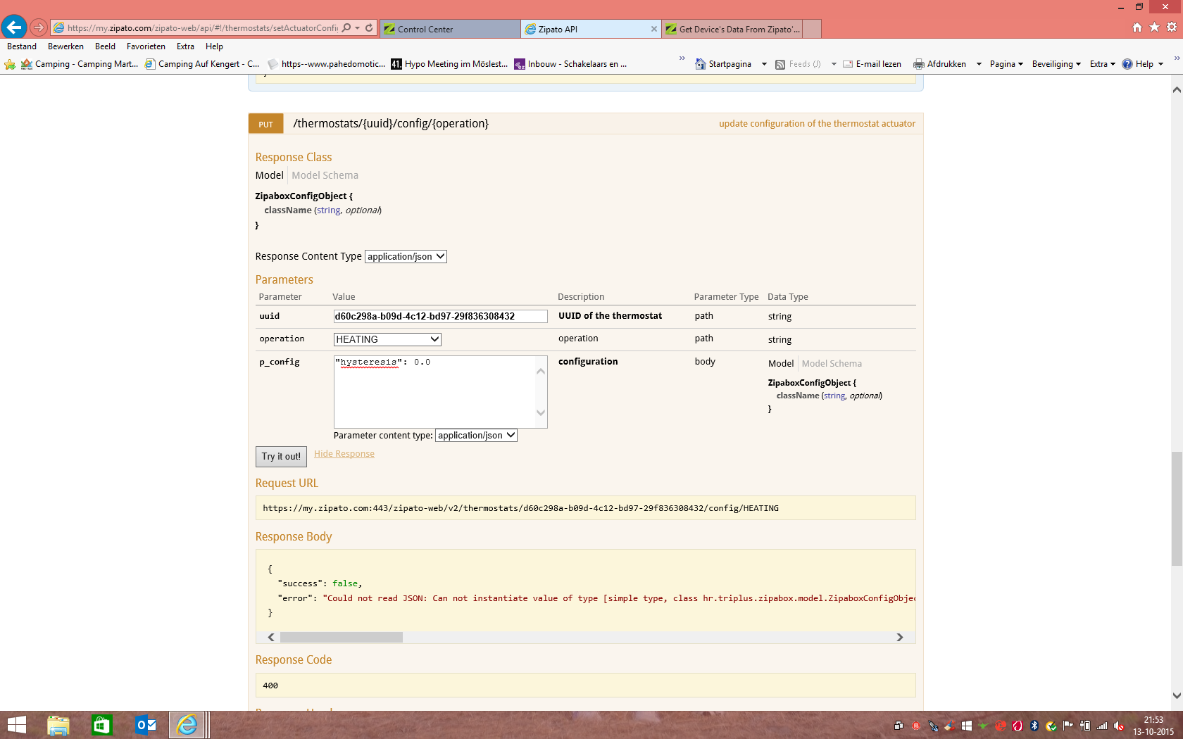

I think I changed the setting to 0 in the API without paying. Let see if it works over the next days

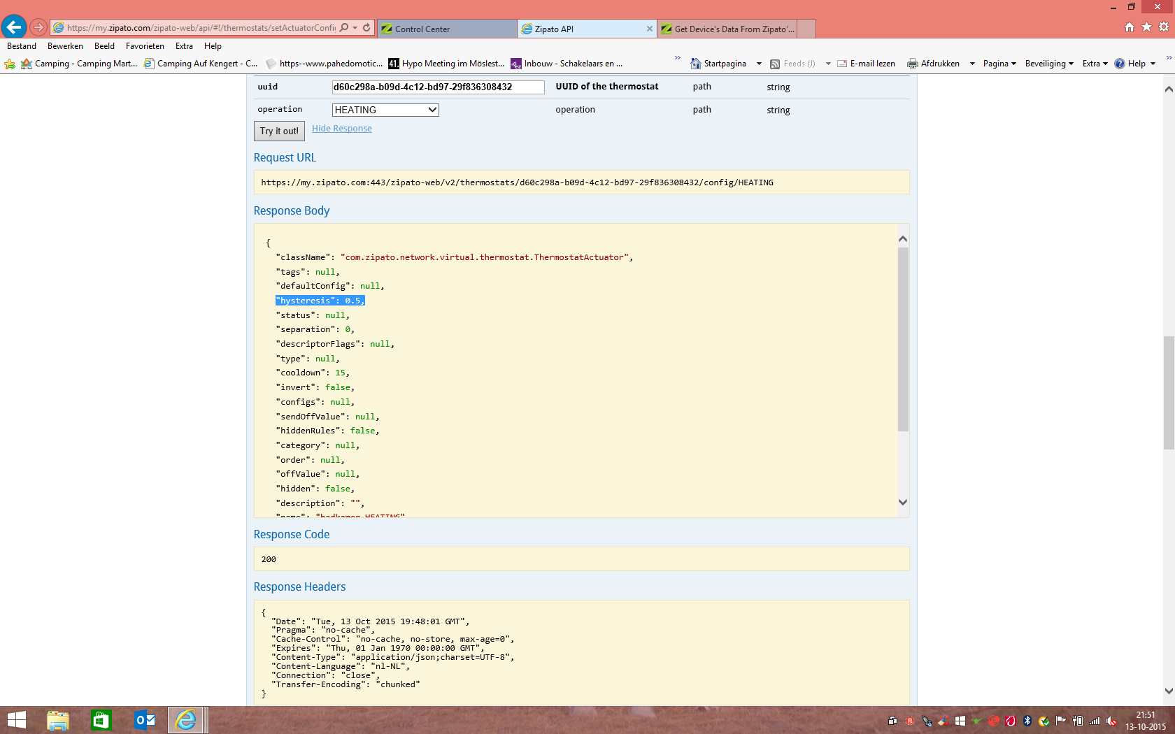

As far as I understand, if you set the temperature on 20.1, and hysteresis is 0.5, the heating should stop at 20.6 and start again at 19.6. It should not stop before it reaches 20.1.
I think that Zipato have changed hysteresis. Last winter, I think that hysteresis was 1.0. My ovens stopped at one degree higher than my temperature setting and starter again when it reached 1 degree lower than my setting. The fluctuation of 2 degrees was not very comfortable. Hysteresis of 0.5 will be much better, but I would of course like to decide the hysteresis myself. And I will rather sell my Zipabox than paying 99 euros a year to get this feature.

it works fine now.
it works fine now.
Yes, I have checked my heating tonight, and it works with the fresh settings. That is good news. No more going from too cold to too warm.
