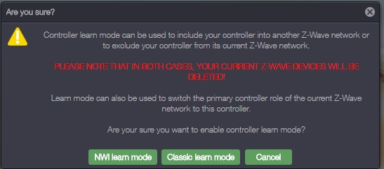

I really want to test this functionallity on zipabox / zipatile but I wonder what is the difference between these two learn modes;
NWI Learn Mode
Classic Learn Mode

Hi Alberto, This is a thing that we still did not receive answer from Zipato. These ioptions should be chosen when someone wants to include a secondary controller (like the Aeon USB stick). I have no idea which one to chose as I have not received a message from Zipato.
The best way would be if someone has a usb stick and tries with an existing small zipato network to include the usb stick as classic mode.
I will open a ticket and try it out. Now that cluster capabilities and architecture has been revealed I don't think it's the best solution for me (or anyone with multiple controllers in a house with only 1 security partition).
I have two dumb zipatiles at home just sitting there used as graphic interphase to my zipabox with handles all the load of devices. I'm going to try first the classic and then NWI with both zipatiles and see what happens, hoping I can notice something.

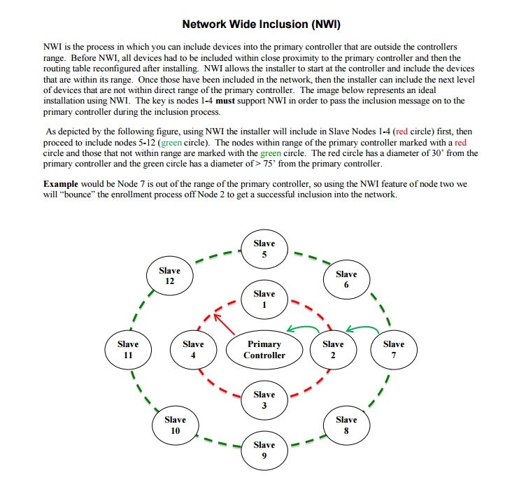

Check this out, I've got some info from zipato. Classic Learn mode includes devices in direct range of the controller, NWI (Network Wide Inclusion) can include devices to the controller which are not in direct range of it but in direct range of NWI capable slaves.
I guess I will give it a try with my two zipatiles and a few extra devices I've got.
yes the NWI is for newer series 5 chipsets. They have the ability to broadcast in full power, while the older devices, and some battery devices only broadcast when including into a network, in low power. This was initially designed for a more secure inclusion process, meaning you had to be within 3 feet of the controller. But as security features have increased with home controller id and device id and encrypted keys, this does not need to be done in low power mode only.
