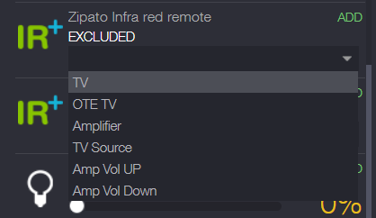

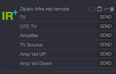

I have a ZXT120 ir and with that i control my AC and i have some extra commands on it.
so for the extra buttons i can send on/off commands for the tv,amplifier,sat, etc.
I want to create a rule so when i press a virtual switch to sent all 3 commands so they all turn on.
but i can't see the commands in the rule section, only in the scenes but there i can only choose 1 command not all 3 of them.
Any ideas?

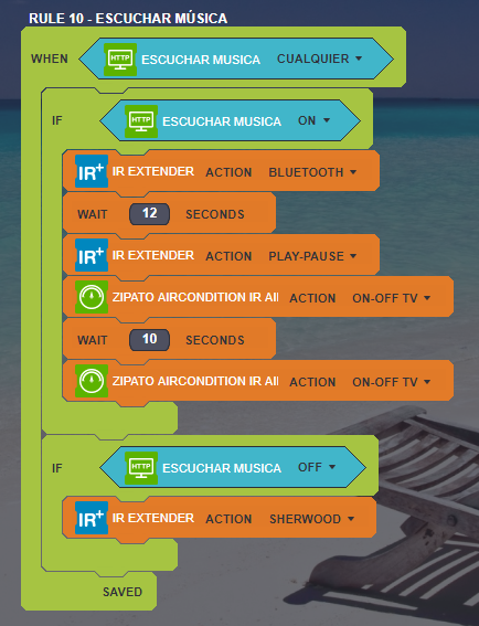

el zxt-120 aparece en el creador de las reglas en la parte de actuadores como "Zipato AirCondition IR" y para lo que quiere hacer debe crear un conmutador virtual y crear una regla que, cuando se active, envíe los comandos IR y desee para enviar varios, debe poner un tiempo de espera de 5 segundos para enviar el otro.
in the example of the image used two infrared emitters to listen to music a global cache to power an amplifier and the ZXT-120 to turn off the TV decoder and video beam.
