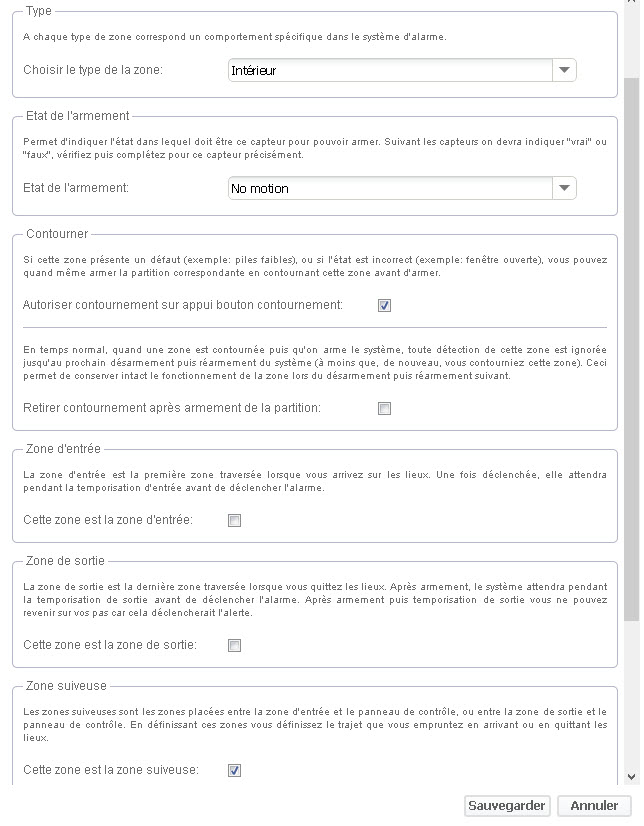

Thank you Sebastian.
I put the multisensor in the Follower zone.

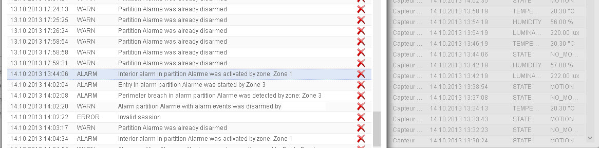

Hello Sebastian,
Same behaviour with the FOLLOWER zone checked.
The alarm was triggered when the motion sensor changed to its default state NO_MOTION.
Any idea ?
