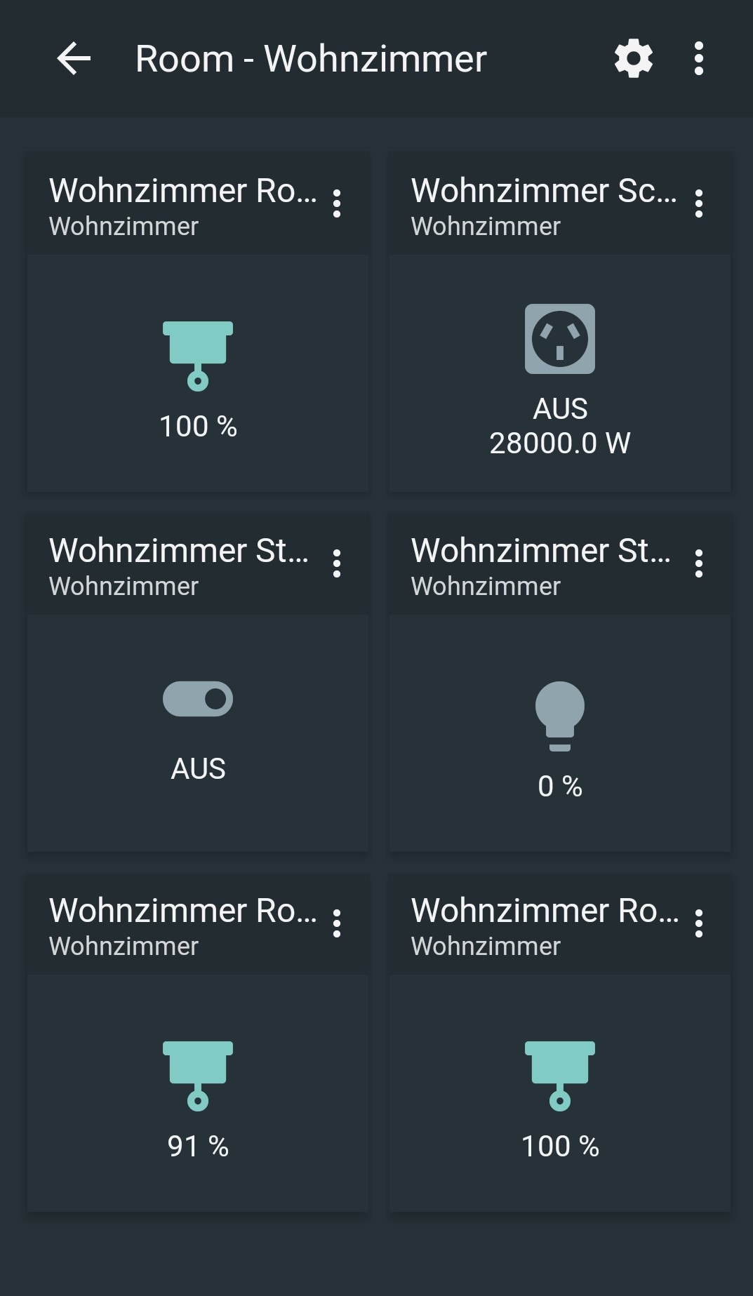

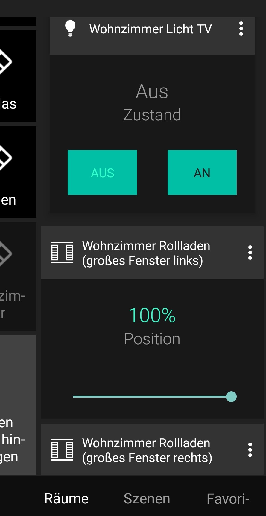

The next big issue I have is the display of the devicenames on the dashboard icons. There need to be a line break of the devicenames or more space. Otherwise I can´t read the the full device names, see comparison between old and new App in attachment. And writing a short name (e.g. general names like rollershutter, light etc.) doesn´t make sence, because nobody could differentiate the devices anymore in the app or rules.

But what about the device names of the dashboard icons/widgets. It is really to short, see my example. When I just write for example rollershutter, I will not be able to differntiate in the app all my rollershutters. I mean espacially when you want to add devices to a room.
When I go on the room seeting (three dots), I choose devices and plus. Then I see the whole device list. But if these device are not clearly named, I will only see a lot of rollershutters, lights etc.
But maybe I didn´t worked out an efficient way to do so =)
device name is one title and ability name is another title. Ability name = device name+ability title (default)
Both names can be edit by user so you can make it easier for recognize in the device list.
The approach in the device list in the mobile app is to present each device in two title rows - ability name + device name. In this way you can generate unique names for every ability since device name should be unique and every ability inside device has its unique name.
