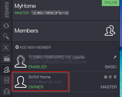

you have to add contact which has defined e-mail address. If you have any issue with sending message, please test your rule with a virtual switch - just switch virtual switch to ON in order to trigger rule.
Thanks but this is the case, see below ... still does NOT work
/6f744fd11926492598e1ee14d30ba140
Any help would be appreciated
