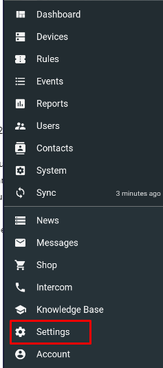

geofencing must be enabled in the mobile app settings:
1. Open Main menu and select Settings

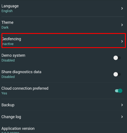

2. Open Geofencing option

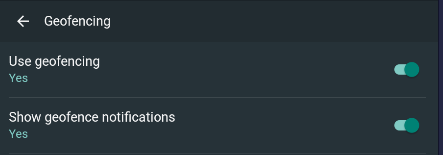

3. Enable geofencing option and notifications (option)
