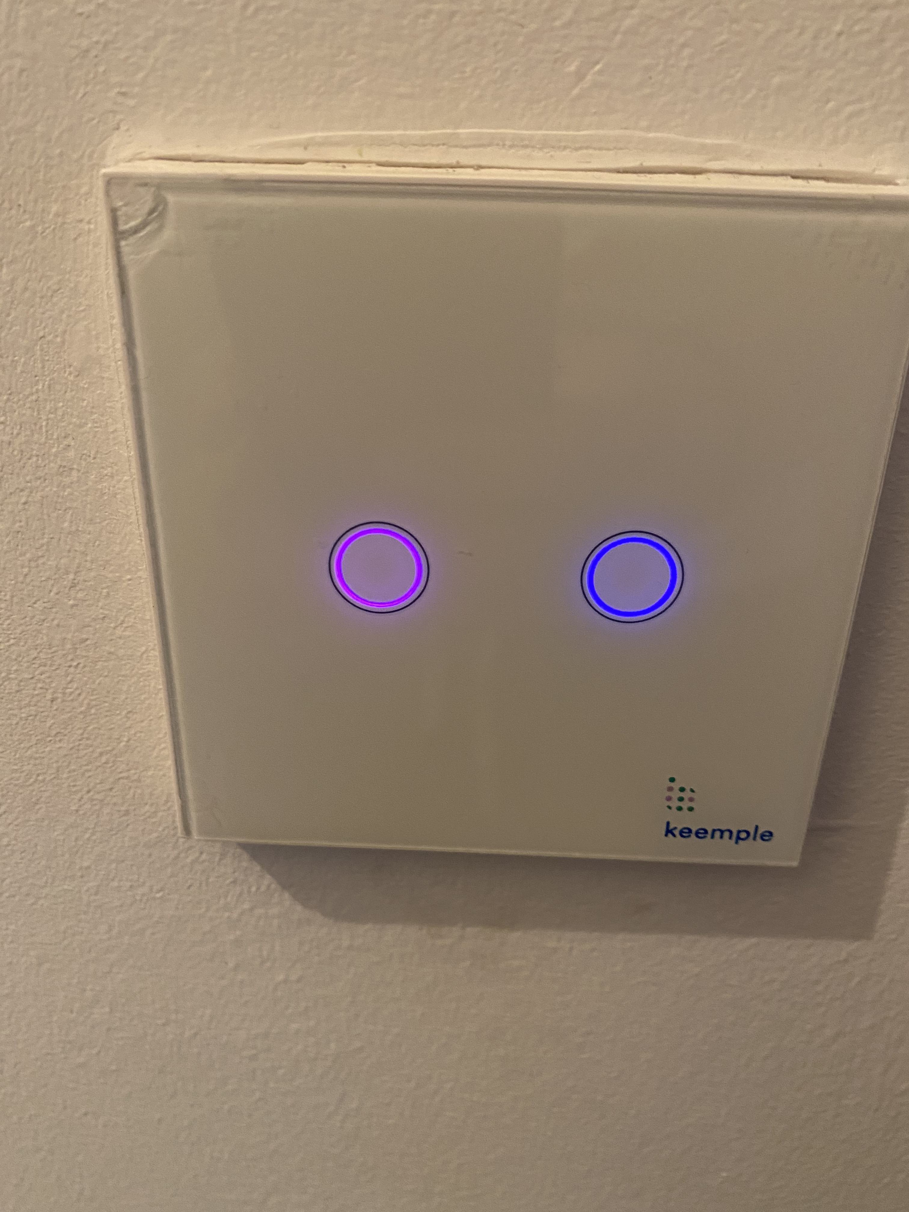

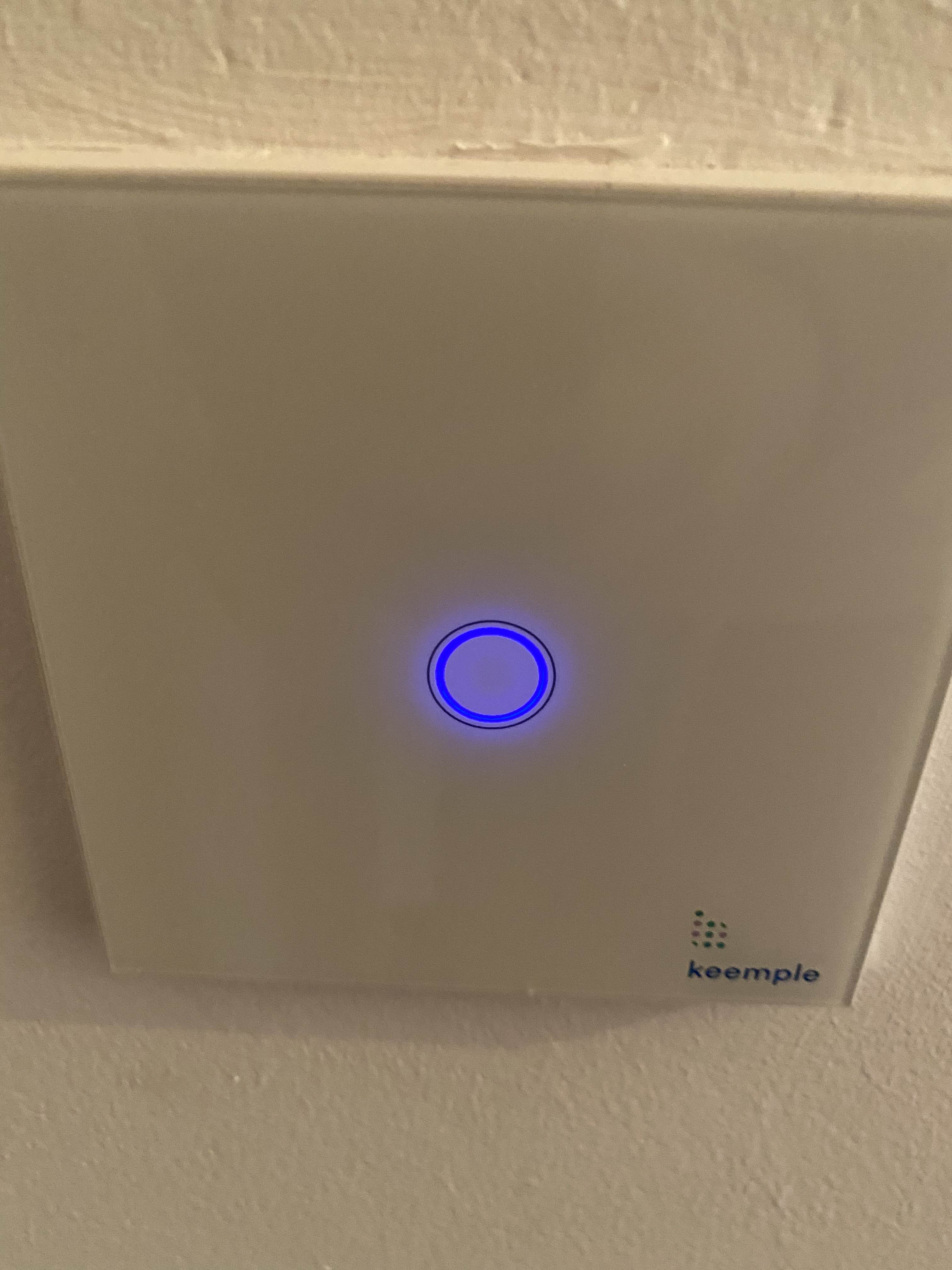

I have 2 on/off switch (Corridor Left and Corridor single). As an alternative switch, I would like to use the two switches for one lamp.
I want both switches to turn on the light AND set the other switch.

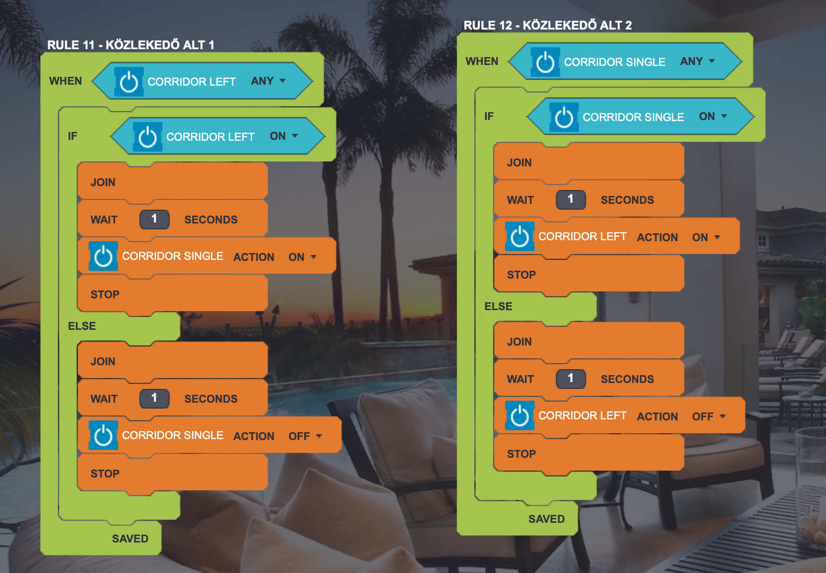

your rules set another switch to the same state (if ON-> another set to ON and vice versa) but it is not visible if lamp is set to ON or not.
I turn on 1st switch but the rule does not turn on the other switch.

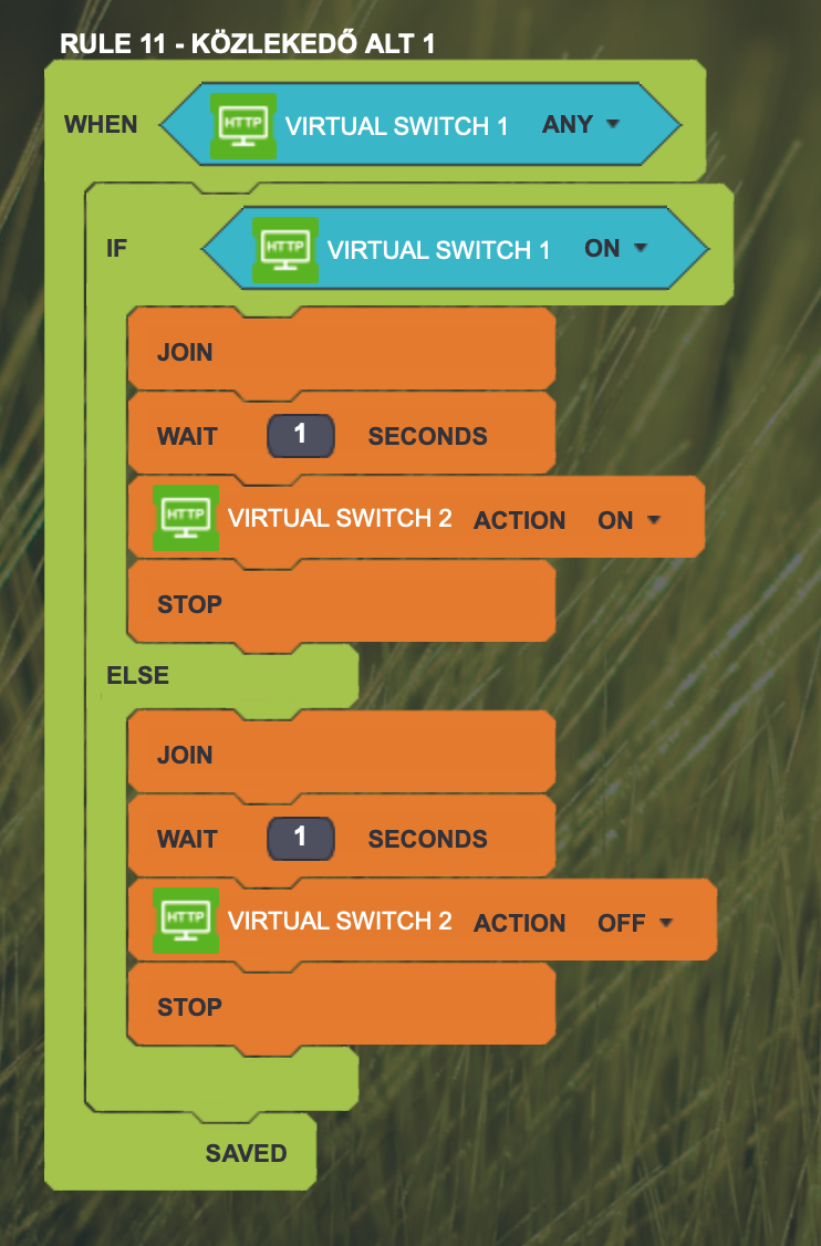

in this case the best debug approach is to use virtual switches and see if virtual switches are turn on/off instead of real switches - in this way you can avoid a potential issue with a wrong device's endpoints.

just add virtual switches under these rules for example 1 virtual switch before IF loop and another inside IF loop to check if the rule is triggereed and IF loop works.

I changed. How can i test this?
ps: what's the problem with my original rules?
