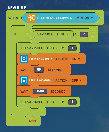

OK I think Dino misunderstood your question. You want that for 1h the pump is not triggered again by a motion. In that case do it like this:
If motion and variable pump !=2 (you have to create this variable before) then switch on pump and set variable pump to 2, wait 60 seconds, switch off pump , wait 3.600s and set variable pump to 1.
The variable Pump is set to 2 for one hour and prevents the rule from being restarted. Only after one hour it is set to 1 again and releases the pump again.

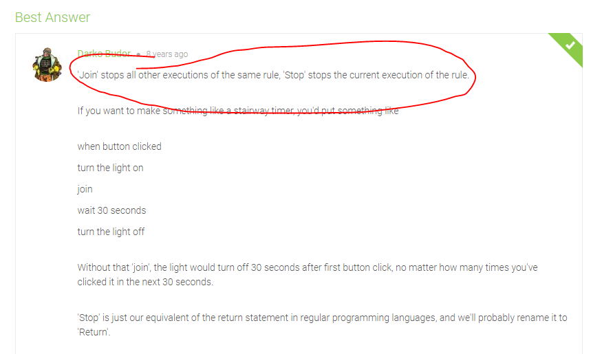

Hi Dino
I think this is a misunderstanding. "Join" does exactly the opposite of what Tiago wants. "Join" ensures that if the triggering event occurs again, the rule is aborted and restarted. This is very important if, for example, you use it to control the light.
I have also just created a test rule and it works exactly as expected.

When I fired the trigger several times under 60sec, I always received message 1, but never message 2. Only when I waited 60 seconds, I received message 2. In Tiago's case, this would cause the trigger to trip the pump over and over again, and that's exactly what he doesn't want.
Hi Dino
Here are explained Join puzzle among others:
https://community.zipato.com/topic/use-of-refresh-all-join-and-stop-puzzle-pieces_2
Join doesn't restart rule but blocks it from the triggering while executing.
Hello Dino
I followed the link and found exactly what I wrote:
Hello Dino
