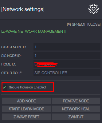

try to include (pair) it without Secure inclusion. We have tested it and it works.

Please, can you give a bit more detailed instructions? Where is the "button" to switch OFF the "secure inclusion".

under z-wave network settings:
Thanks, no help, it was already OFF. I try in both modes, still, even the device is visible, system doesn't finish the process.
