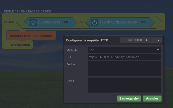

I use shelly with my Zipato Box.
I create virtual switch and with http API request. I switch on bulb in Shelly 1.
Hi Olivier,
you can show a screenshot of the http request?
Hi Lars
You have this in my first post.
I've too a Shelly 2.5 for my shutter:
Virtual switch : http request to "http://<<IP_SHELLY>>/roller/0/?go=to_pos&roller_pos=100"
